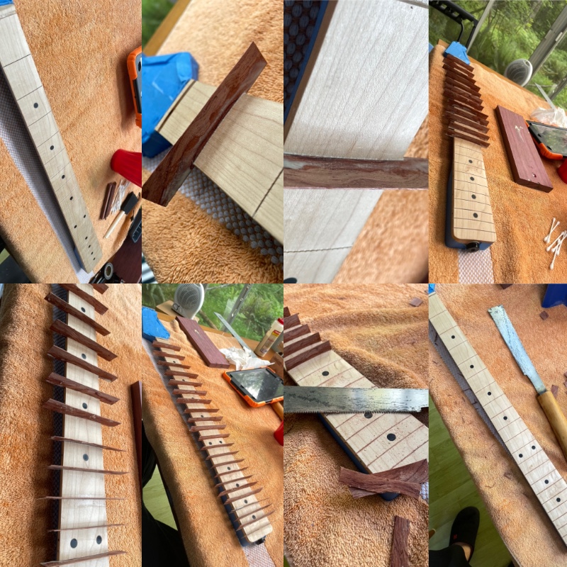

This is one of those projects that kept growing..
I bought the Chevy green sterling body cuz it was cheap.. had a old olp neck but.. it was a bit bigger than the neck pocket.. this lead to two thoughts.. one.. I’m tired of fitting necks to bodies.. two.. this meant sterling got the us str5 neck shape right.. and dude also had the neck so I bought it..
was going to use old olp bridge and pickup but.. so I get the neck.. the frets did look seated very well… and I’d wanted a fretless 5er.. so I did a test pull and the fret came right out.. I had them all out in 20minutes..
this was cool! So I went looking for a better bridge… and pickup.. and preamp..
today the fret slots were filled.. this a messy and annoying job.. but they are all in

Yesterday trimmed to fuller strips and did a quick rough sand, pp. I will now let it sit and cure and settle in for a week.

what wood are you using for the fills?

dubkitty wrote: Fri May 23, 2025 6:01 am what wood are you using for the fills?
Bubinga, I got a huge multi pack of veneer and that piece fit the slots the best

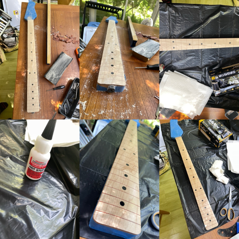

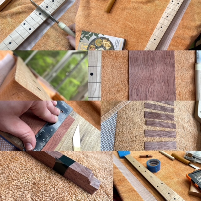

Got off work early yesterday.. did some fingerboard leveling and 7 coats of superglue

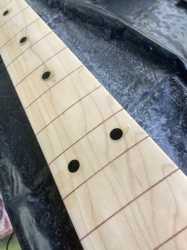

Today doing spot filling on the dots.. why? Because Sterling did not install thin where when you level the board they match the board curvature… I assume it’s to save production time.. but for me it’s annoying…

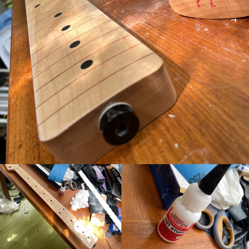

Fingerboard is done… I hate sanding ca glue!!!!! Now I know why it’s almost been 20 years since the last time I did this.. (that was a double bass fingerboard I carved out of Pau ferro, the finish is still intact… think it was 13 coats) anyway used a whole bottle of hot stuff.. sanded to 2500 grit..
Now.. waiting on a neck plate (the one from china was a rectangle.. musicman neck plats are a trapezoid… oh well I’ll use it for something else… then need to install the new hipshot ultralight tuners, drill the body for the new bridge and wire it..

I’m sure it’s overkill.. I don’t use roundwounds very much… yes I sanded or at least scuffed between all the coats..
The reasons why: cheap neck, don’t trust fingerboard’s hardness. And the harder and smoover you get the surface the cleaner your notes and more importantly harmonics are. For sound/playability if I was going to build a neck I’d use ebony or something stabilize..

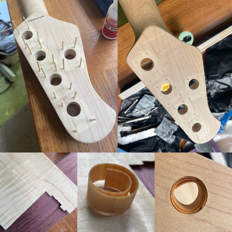

Filled the old tuner screw holes and cut some veneer strips to use as spacers to go around the tuner bushings on the new hipshot tuners so there is no slop.. these fucking cheap bass tuners these companies are using… the G&L neck I just used on my other project the holes were too small.. yet the us made versions of both musicman and G&L use the same tuner….

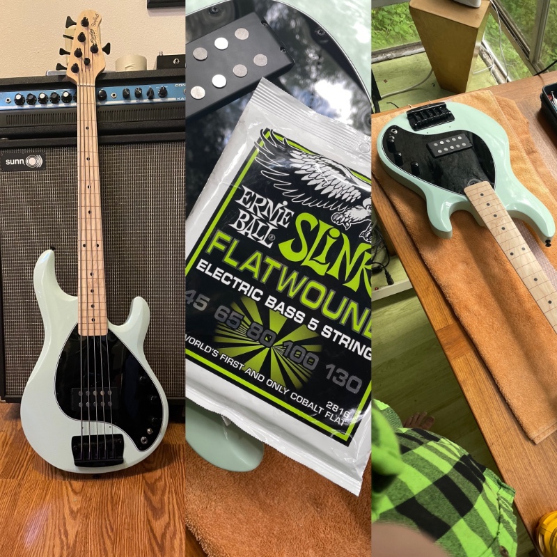

Ok, powered through and am done. Totally done.

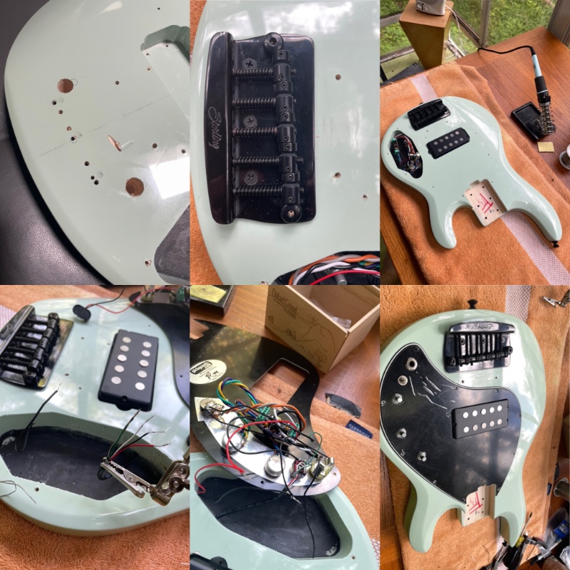

Installed the better musicman accurate bridge, and wired it up. Pickup is a nordstrand mm2.5 with a bob’s fun stuff 70’s accurate preamp. I also wired in a series/parallel switch
Strings are ernieball cobalt flats.
Had to add a .5 degree shim get the action right.
Plays like budda, sounds like a… stingray.. :p
