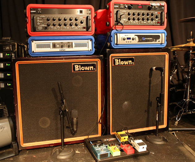

So my favorite guitar players are King Buzzo and Dylan Carlson. Both of them these days use pedals into solid state amps and um, "unconventional" cabs
Here's the most recent pic of Buzzo's rig I can find without digging around too much
One cab is a 2x15 and one is a 1x12, 1x15.
Last I read, Carlson was touring solo with a trace elliott elf, an inexpensive teeny tiny 200 watt bass head. They seem really cool and have me interested. From watching youtube it seems like he just uses whatever is around.
