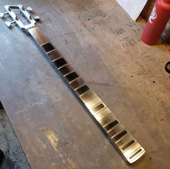

The exact neck I'm getting:

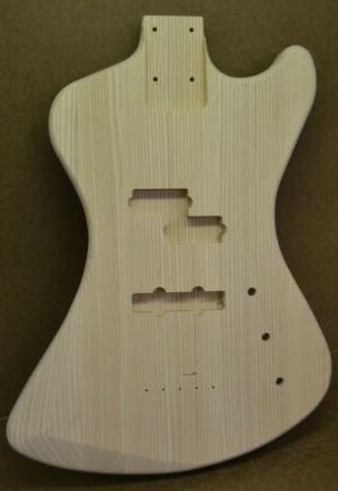

The body pre-paint and routed to not my pickups:

Is that your neck or just the style you’re looking to have built?
Re: I'm building a bass INPUT NEEDED!
Posted: Thu Jul 11, 2019 3:20 pm
by JonnyAngle
odontophobia wrote:Is that your neck or just the style you’re looking to have built?
Unpolished with black block inlays

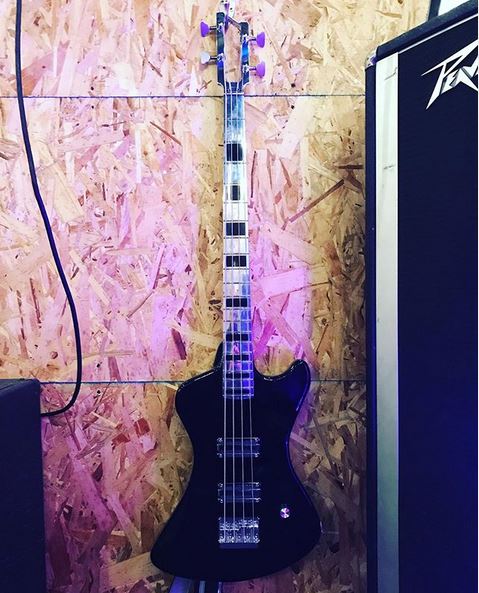

by JonnyAngle
bass is done. both pickups in parallel. Wired directly to jack. the volume knob is just for show at the moment.
