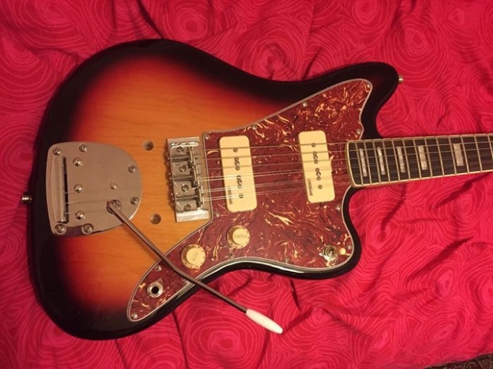

So I saw this on a Facebook page for Jazzmasters, not sure if the guy's a member here, if you are, kudos, and please give me your blessing to do this myself. (Also sorry it's not *quite* a twelve string.
Here's the guys post, with a vid link:
I've just finished (well partly) a prototype of an idea I've had for about 15 years. The idea is to have a 12 string, where 6 strings are fixed in a tele style bridge, and the 6 others pass the bridge to a Jazzmaster tremolo. I was hoping for a manually controllable chorus sound.
For this iteration, I got a cheap but decent Harley Benton Jazzmaster copy, and installed the tremolo and a half ashtray bridge. I had to raise the bridge with a piece of aluminium to get the right angle for the strings. I could easily fit 3 extra tuners, so at the moment I settled for that.
The result is less exciting than I hoped for, but I'm starting to figure out what to play to make it sound the way I dreamed of. Maybe I will experiment with having the D, G, and B strings doubled instead. I will also install a pickup behind the bridge for more atonal sounds.
If anyone else has tried this, please share your experiences!
Sorry for the hum in the video, I haven't connected the ground wire to the bridge yet. Also for the guitar playing, haven't touched a guitar for a couple of years ;)
https://www.youtube.com/watch?v=J-inbM3yJZQ

This is fantastic, sounds a lot nicer than I expected from the post
Re: Show me your electric 12 string guitar
Posted: Sun Oct 09, 2016 2:31 pm
by coldbrightsunlight
That sounds like an incredible idea!

Haha I've been doing this to the SG I've been building for the past year and a half.
I thought I was so original, oh well. Good to hear it works though.
Although I'm doing it with a TOM and a teisco vibrato
