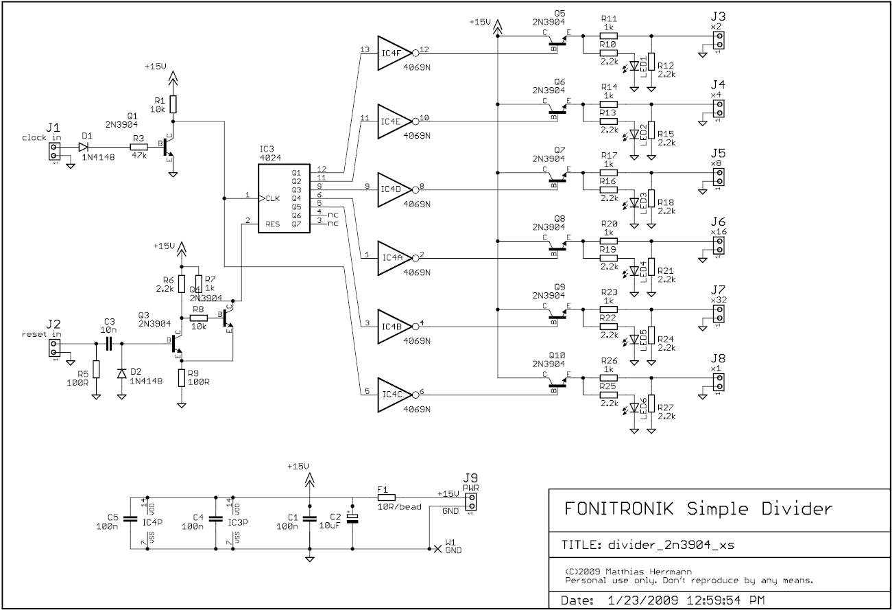

It's my first for eurorack. A simple 4040D clock divider. My biggest concern is the power header and power related components as I'm a bit wary of harming my supply and other modules. I've double checked it but could really use another (or a few more) pairs of eyes. Assume that there are cuts under the length of the IC as well as under any horizontal components. The top unlabeled resistor is 470R and the lower right unlabeled one is 10R.
It's pretty much based on this http://electro-music.com/forum/phpbb-fi ... er_115.gif just with simplified output and no reset circuit.
