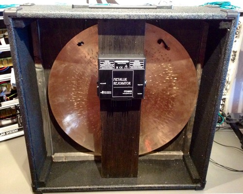

So yeah, I'm basically trying to do what Eowave is doing with their Metallik Resonator. Here's a look at the Eowave gong in a cab. I'm just going to use a stand for the gong...although I wonder what sort of effect, if any, a cab would have on the sound?
here is a look at the surface transducer attached to the gong. i'll need to drill small holes in the gong to attach the transducer. you can seen the amp they are using on the base of the cab.
