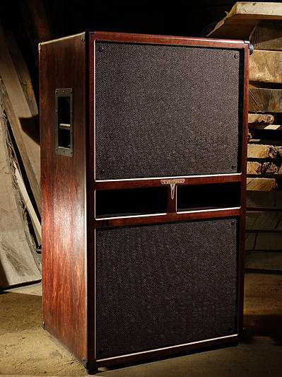

This is my original post titled 2 x 15 Bass Cab Designs
and it read...
Does anyone have any plans for something like this?:
Original thread found http://www.talkbass.com/threads/custom-diy-2x15-cab-build.854517/
I really want to finish something like this:
Those Tyrant Tone cabs are lush....
Also really want to stick a nice stainless steel grill on it with a mahogany wood finish.... Mmmmmmmmmmm
