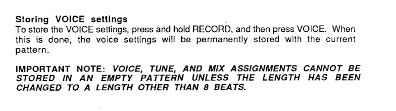

Is the machine automatically supposed to save settings you alter? - like pitch of the drums? If not, how do you save the settings? I tested the internal battery and it's good so that shouldn't be an issue.

dude, the manual is attached to the top of the device…
also, this is what u want.

Ahh, so you can have different kit sounds/voicing for each pattern?

yea i think so
