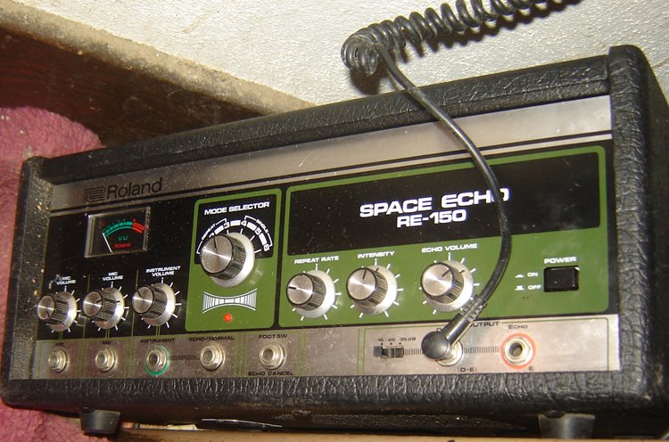

This sounds like an excuse to buy an Echoplex or Space Echo or other amp-top unit to 'dampen the vibrations.'

Space echo!!!!!!

Psyre wrote:Space echo!!!!!!
With genuine coily cable, black from sin and strangling babies.
