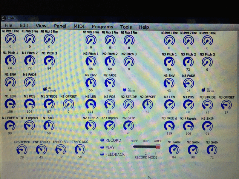

Any one else using Ctrlr software with the 856?
Here's a screenshot of the controller I made.
https://www.dropbox.com/s/9v0yqjpojylun ... 0.png?dl=0
You can download the software from ctrlr.org.
I'll be glad to share my panel with any who want to try it.

wedgehed wrote:Here's a screenshot of the controller I made.

Nice!! I’m a Ctrlr controller too!
My midi capabilities are really limited, so Ctrlr is my go-to for the 856. Actually built a template using the v1.2 manual only to realize there were diffferences with 1.1
I’m sure there are other options, but for me, it really opens up the 856, and allows really easy access to octaves etc.

I'd love to give it a whirl! Been experimenting with MIDI, so this would be a huge help.wedgehed wrote: I'll be glad to share my panel with any who want to try it.
Very cool! Looks like something I can get behind.fuzzisokiguess wrote:I’m sure there are other options, but for me, it really opens up the 856, and allows really easy access to octaves etc.

I think you can download the panel from this link. Hit the "More" tab (3 dots) for the download command.meanmedianmoge wrote:I'd love to give it a whirl! Been experimenting with MIDI, so this would be a huge help.wedgehed wrote: I'll be glad to share my panel with any who want to try it.
https://www.dropbox.com/s/iuqacdhej5t03 ... panel?dl=0
Let me know how it works for you.
