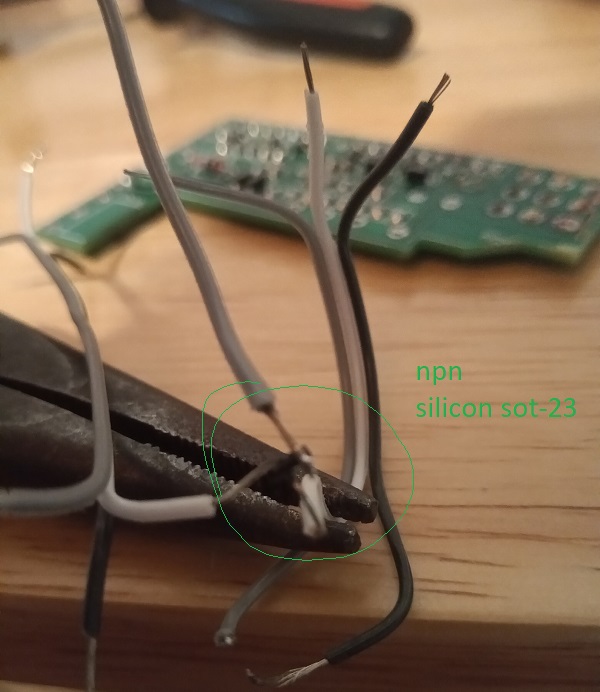

yeah it could be 2N2222. the atlas DCA55 will tell me when I get it hooked up.

hello, sorry for the delay. reverse engineering continues. there are 5 of these Hfe 195. 2 of Hfe 953. I believe there are 5 of 2N2222. also 2 of 2N5088 or 2N5089. there is a small chance MPSAXXXX. over 850 seems high for a 2N5088. I don't think you would hand sort sot-23 package 2N5088. usually my DCA55 will auto detect a darlington silicon transistor. this did not detect a darlington. that is the best guess I can make as to what transistors are inside this thing. I can make the PCB soon. I have to trace it some more on my own. this will take time. then I can make the PCB after all the correct cap values are in the right places. I have the cap values on the PCB but I did not get a copy of C1 C2 C3 etc. that was on Jon's computer. maybe he can help me out?

Devi did use a lot of MSPA18 as well, but yeah, if your magic thinger didn't detect Darlington :shrug:
I wonder how critical the current gain is for those 2N5088s. Maybe they're not sorted at all and they just happen to right at the higher end of the typical gain spectrum?

in my life, I have seen 550 to 850 Hfe on a 2N5088. I can't remember 2N5089. those were the high gain version? so yea this is pretty well known to be a high gain variation of a 2N5088 or 2N5089. 950 is really close to 850. darlingtons start at Hfe 2000 but they are less when damaged by heat. maybe there is a darlington with Hfe 950? it was many years ago when I would buy every transistor to test them out.goroth wrote:Interesting.
