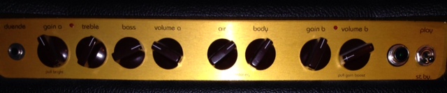

Syl, what settings do you have across the board for your Bogner? I had to play around a lot until I got happy and my settings have remained stable, though I have to switch pickups depending on A or B or the blend.
great trades with: Lintybits, smallsnd/bigsnd, bennybanana, julius_deane, bass_econo, rustywire, jbf3, Dandolin, goroth, devnulljp, Helter, Justinm1789, Inconuucl, NDominy, Uncle Grandfather

Here's my setup:

Sweet, just thought you might be conflicting the EQ on A with the Body/Air. Similar setup to mine though I have a touch more Body, less Air, and less Bass in A stage than you have. I tend to play with bright switch pulled too.sylnau wrote:Here's my setup:
Hope it works out this eve!

I'm not using the bright switch... not working great with some pedals.
