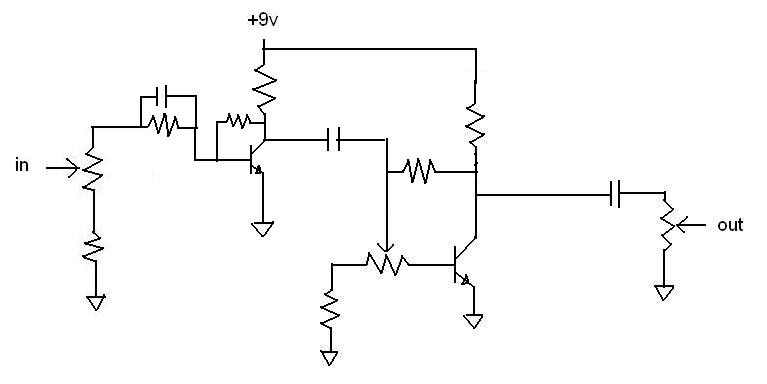

The middle pot would limit both base current and collector current because of the feedback resistor connected to the pot. With the pot all the way up, the base current will be highest, and the collector current will be lowest. With the pot all the way down, the base current would go down, but the potential for collector current would go up.
I word as "potential" because the collector current is going to be relative to the base current.
Gating is caused by either low biasing at the base, or too low of signal at the base. Proper biasing would allow very small signals to be amplified, though. You could also force the signal to go through a set of diodes.

Ok, I'm understanding like 70% or so of that (I think).
What would the effect be if the resistor was removed and that side just went to ground?
It would only limit base current then yes? If that was the case how would that effect how this works?
Would it simply increase the general current collected and output?
(also, thank you mysteriousj, McSpunckle, and eatyourguitar)

jfrey wrote:mysteriousj wrote:Do you mean controlling the gain? or doing it passively after the transistor? If you want to do it passively just put the output from transistor into lug 1, the output is on lug 2 and the 3rd lug goes to ground. You can swap lugs 1 and 3 so the pot turns in the right direction.
What do you mean doing it passively? I'm not sure if that is what I was trying to get at.
What I'm asking is how would you make it so that turned down all the way the transistor is effectively out of the circuit? Or perhaps I should say it as: the transistors effect on the circuit is controlled by the potentiometer.
Passive means you get no gain, eg just using passive components eg caps resistors, so no semiconductors op amps transistors etc.. But yeah i misunderstood what you were trying to do lololol

No problem. Trying to work out all this info. Reading all the articles and stuff that people post, but most of it seems to explain everything individually without ever bringing it all together.
Assuming I remove the feedback resistor from the middle pot (or adjust the value to get the desired bias(?)) would this work as I am imagining it?
