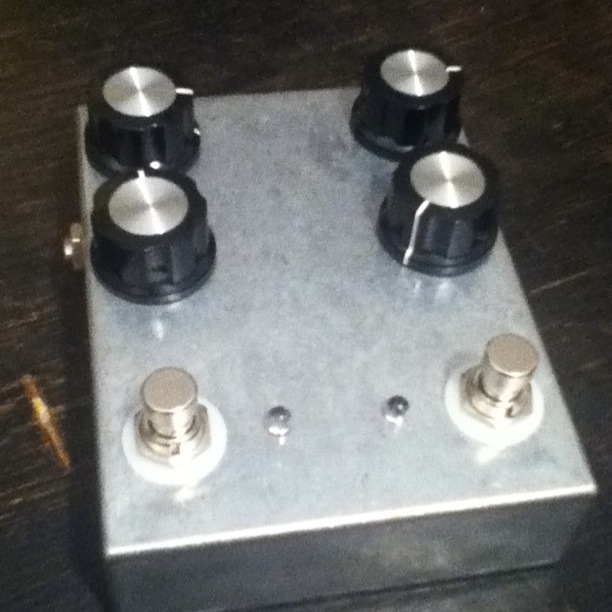

now its done! :omg:

smile_man
Posts: 4531
Location: Toronto
Re: Snowflake kit thread!
Post by smile_man »
comtrails70 wrote:
smile_man wrote:now its done! :omg:
nice!
can't wait to get mine started now.
what chip did you use/get?
I got both, the JRC is in there right now. I should probably try them both out but I'm not taking that thing apart again today.
I enjoy the fact that the two days I worked on this pedal have been days that school has been cancelled due to too much snow. :)*

snowflake pcb build.
today after a few minutes of playing both leds blew out... :cry:
any suggestions on what value resistors i should use? (or should have used :facepalm: )
