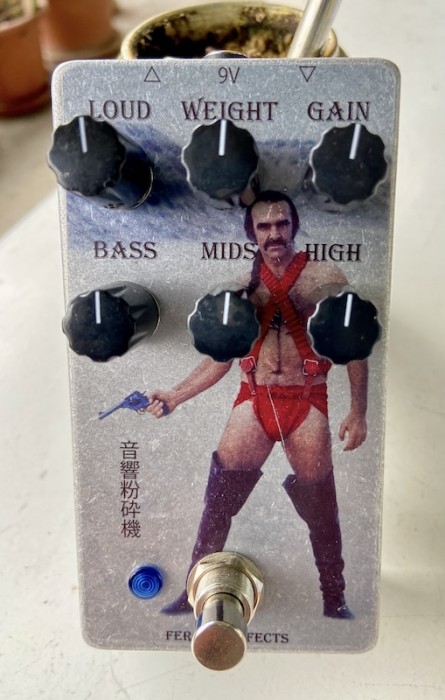

Subarashi boxed up - aka as TAFM; a pedal I failed to buy for years ... so finally, here we go. (Thanks Deadend)
I used a Toshiba 2SA93 for Q6 and a GT308B for Q7 (D9E for the GE diodes).
It sounds AWESOME - also on guitar.

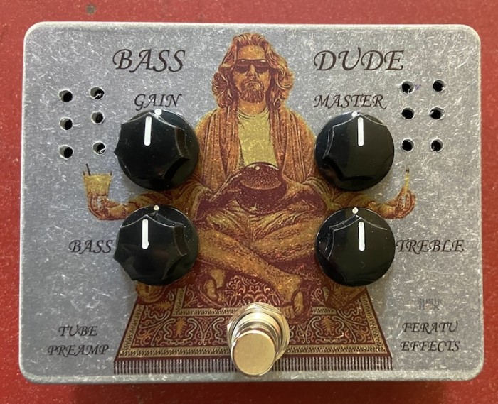

Here's my Sushi Box/C2C Bass Dude, sounds glorious.
his Dudeness!
his Dudeness!
I wanted the Gain to stay clean for at least 50% and then get into OD territory, so I put a 12AY7 / 6072A into V1 ... and a 7025 WA in V2, both from TAD.
Turned out pretty good, here are some notes on the E string to illustrate.
quick test of the gain range, bass and treble are always on 12 o'clock or 50%. when turning up gain, master gets adjusted (turned down).
0:00 clean
0:07 gain 9pm or 25% (master between 1 and 2 pm)
0:15 gain 12pm or 50% (master 12pm or 50 %)
0:25 gain 3pm or 75 %
0:33 gain 100% (master around 9-10pm)
0:42 clean
https://soundcloud.com/fuzzonaut-1/bass-dude-gain-test

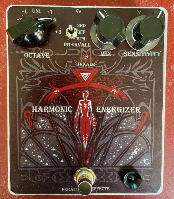

The PCB (from circuitbenders.co.uk) is actually called Harmonic Engine and it is a clone of the Harmonic Generator, a projekt by Paul Williams, published in Electronics & Music Maker Magazine back in 1981.
This circuit uses the 4046 PLL chip (and a lot of others). The squarewave can be set to different octaves (from -3 to +3) with the OCTAVE rotary switch and it can produce 3rd and 5th harmonics via the toggle switch .... Well, that's the theory.
In practice it sometimes glitches and struggles, unless you play clean single notes, often resulting in beautiful chaos and bizarre sounds.
I really like it - as most PLL things.
Here's a sample on guitar.
https://soundcloud.com/fuzzonaut-1/harmonic-energizer

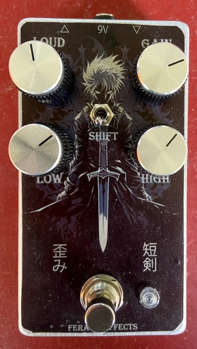

Another Deadend project: LOW BLOW aka Katanasound Super Bass Fuzz.
I matched diodes (D4/D5) and transistors (Q4/Q5) and the octave on the foot switch is very strong.
As for transistors, I have 2x 2SK30A and 5x 2N2222A in there. GE diodes are D9E (D4/5) and D311 (D6/7).
And some "japan/sword" themed graphics, because Katana.
