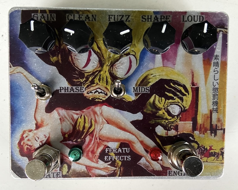

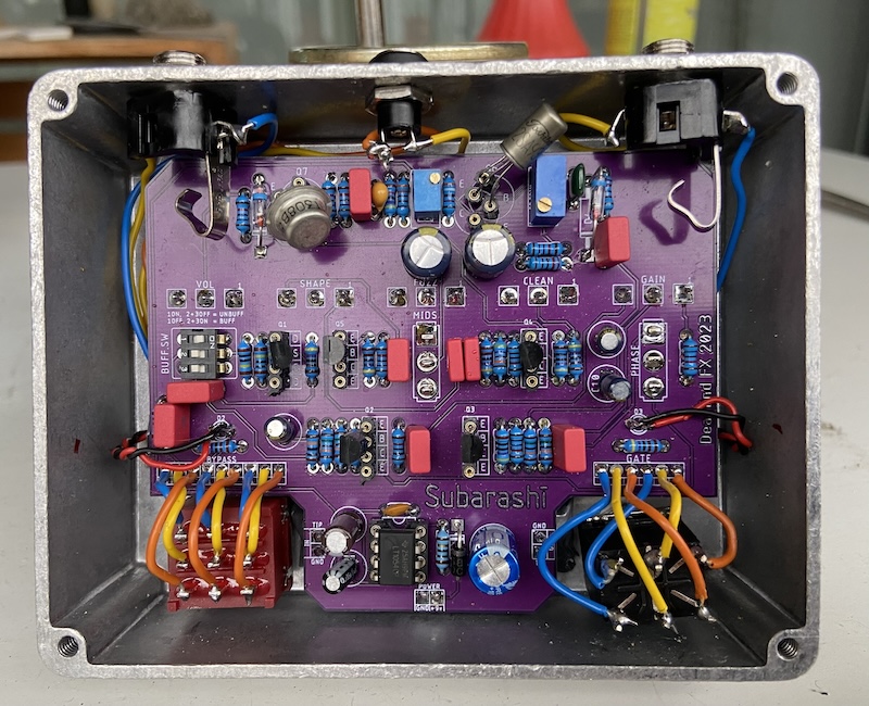

Subarashi boxed up - aka as TAFM; a pedal I failed to buy for years ... so finally, here we go. (Thanks Deadend)
I used a Toshiba 2SA93 for Q6 and a GT308B for Q7 (D9E for the GE diodes).
It sounds AWESOME - also on guitar.

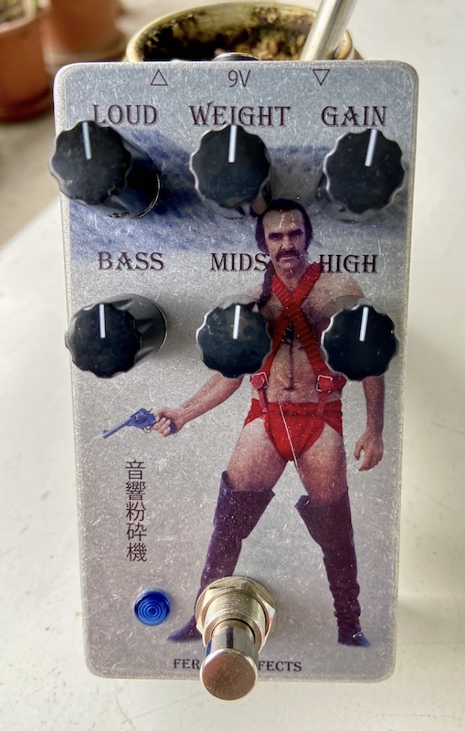

And the EQD Zoar. I made that for my cello playing friend. It really fits the instrument and sounds amazing.
As she always makes fun of my "immature" graphic choices, I gave her Borat - umh, no wait ... :p

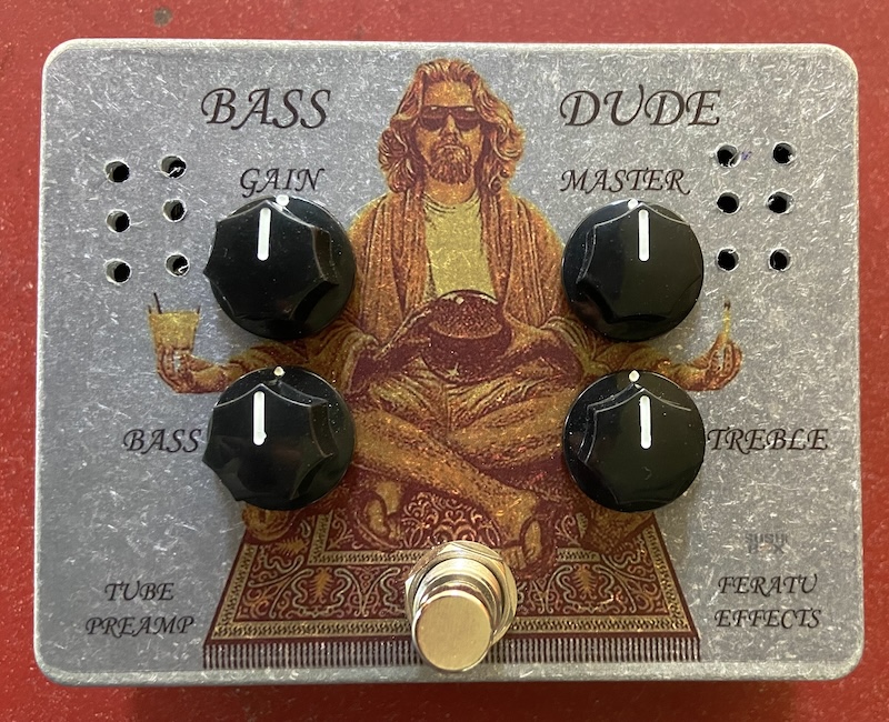

Here's my Sushi Box/C2C Bass Dude, sounds glorious.
his Dudeness!
his Dudeness!
I wanted the Gain to stay clean for at least 50% and then get into OD territory, so I put a 12AY7 / 6072A into V1 ... and a 7025 WA in V2, both from TAD.
Turned out pretty good, here are some notes on the E string to illustrate.
quick test of the gain range, bass and treble are always on 12 o'clock or 50%. when turning up gain, master gets adjusted (turned down).
0:00 clean
0:07 gain 9pm or 25% (master between 1 and 2 pm)
0:15 gain 12pm or 50% (master 12pm or 50 %)
0:25 gain 3pm or 75 %
0:33 gain 100% (master around 9-10pm)
0:42 clean
https://soundcloud.com/fuzzonaut-1/bass-dude-gain-test

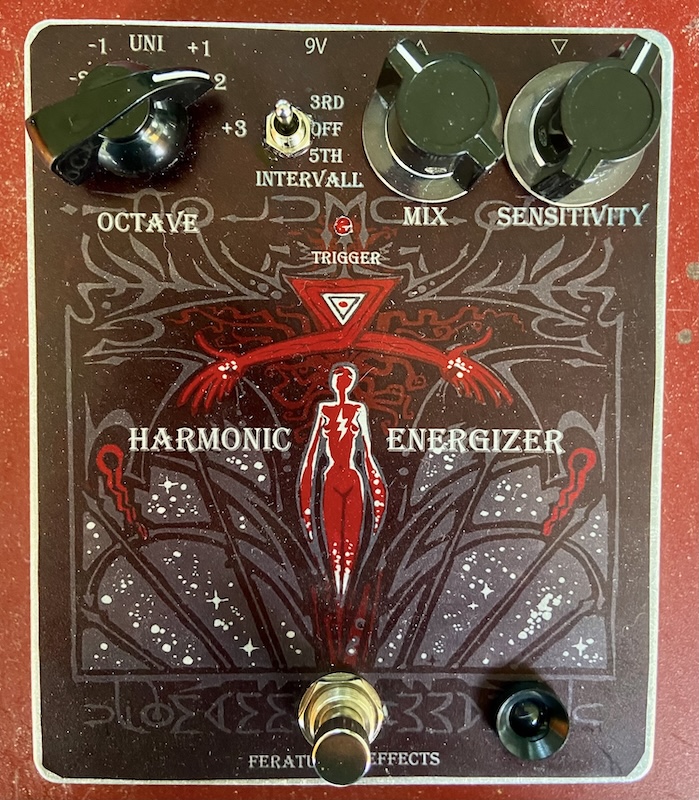

The PCB (from circuitbenders.co.uk) is actually called Harmonic Engine and it is a clone of the Harmonic Generator, a projekt by Paul Williams, published in Electronics & Music Maker Magazine back in 1981.
This circuit uses the 4046 PLL chip (and a lot of others). The squarewave can be set to different octaves (from -3 to +3) with the OCTAVE rotary switch and it can produce 3rd and 5th harmonics via the toggle switch .... Well, that's the theory.
In practice it sometimes glitches and struggles, unless you play clean single notes, often resulting in beautiful chaos and bizarre sounds.
I really like it - as most PLL things.
Here's a sample on guitar.
https://soundcloud.com/fuzzonaut-1/harmonic-energizer

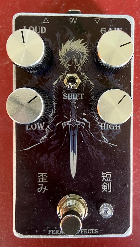

And a clone of the EAE Dagger, on a PedalPCB pcb. There are 2 OP07 in there and the GE diodes I used (D9B) had a forward voltage of 0,3V.
Very cool drive. Sounds great on bass and guitar.

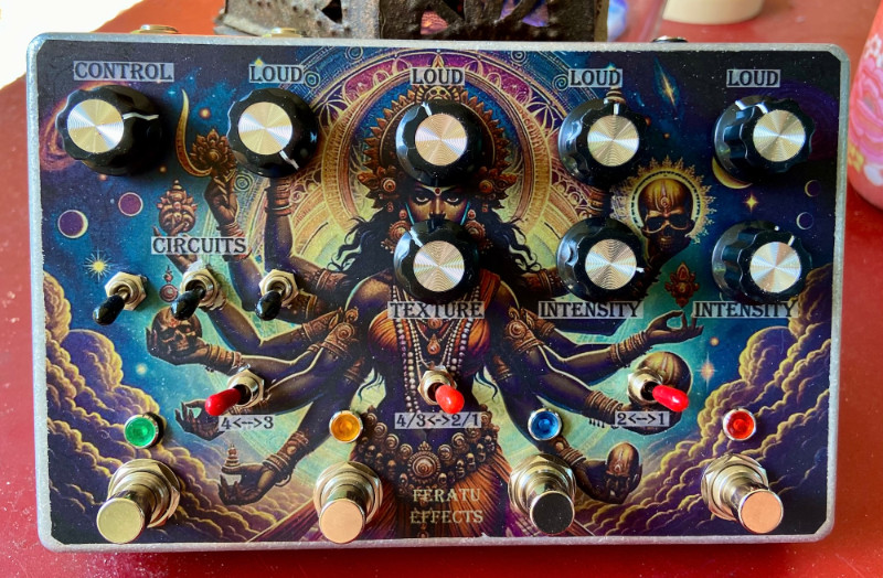

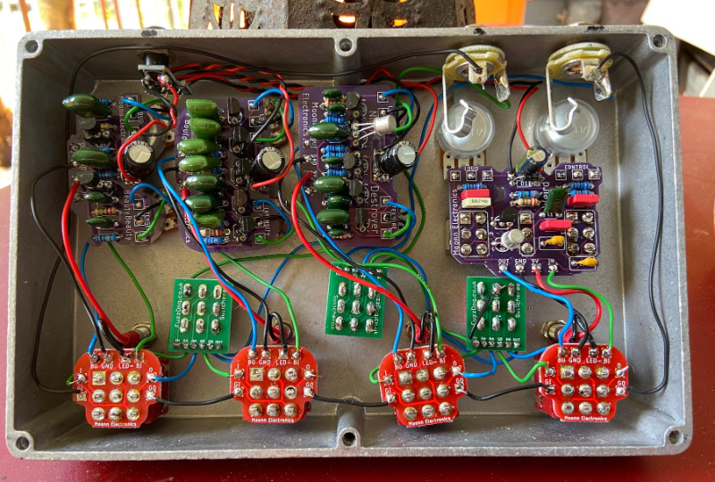

On one of my orders from Moonn, I kinda randomly grabbed 4 Devi PCBs for some sort of hommage noise maker pedal.
Fastforward a few months and here we are - behold the DBBSN (Devis brick of brutal sounds'n'noizes).
We have, following the signal in "standard mode" *** :
1. Ruby, vroom-vroom baby.
2. Stone, brrr-chak.
3. Destructo Octavia, craaaaazy oscillating and noisy signal destruction, so, yeah.
4. Weird Flex, which - with the 3 black toggle switches - should give you the following choices: Punch Love, Punch Hate, Silver Crank, Dark Boost or Karaoke Party
*** There are 3 order switches:
The first changes pairs: 1/2 <--> 3/4
Then one for each pair: 1<-->2 and 3<-->4
:evil: :success: :animal:
:snax:

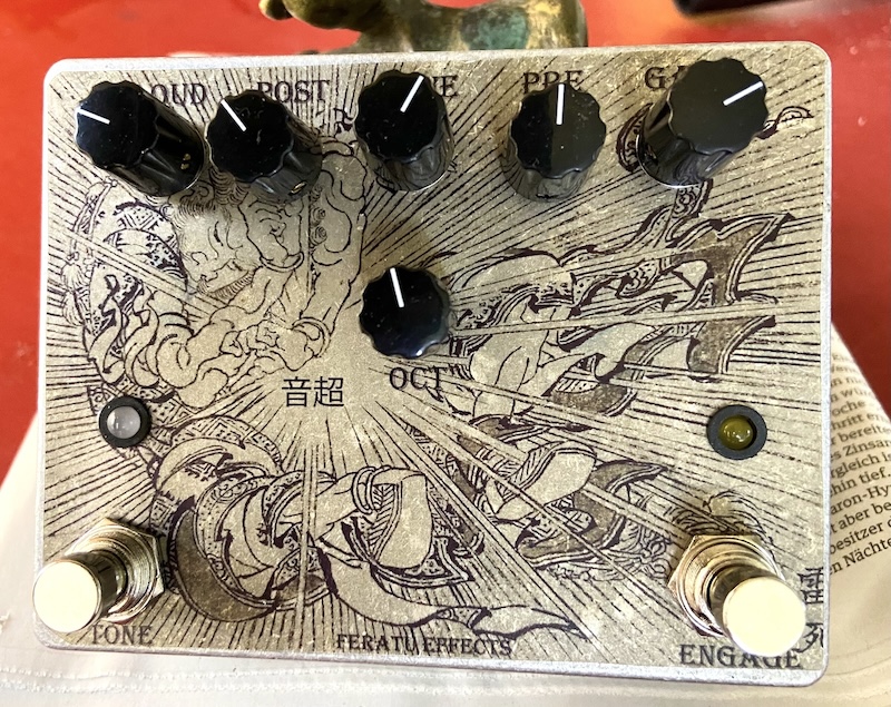

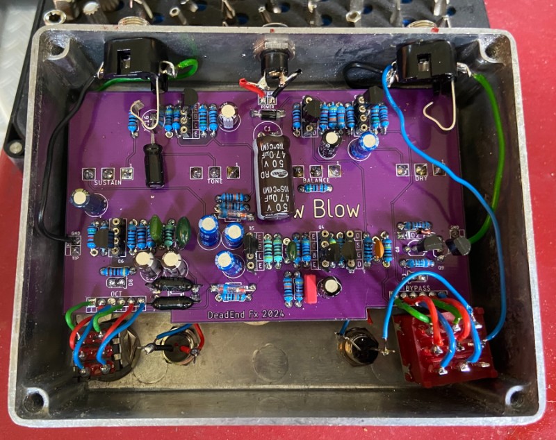

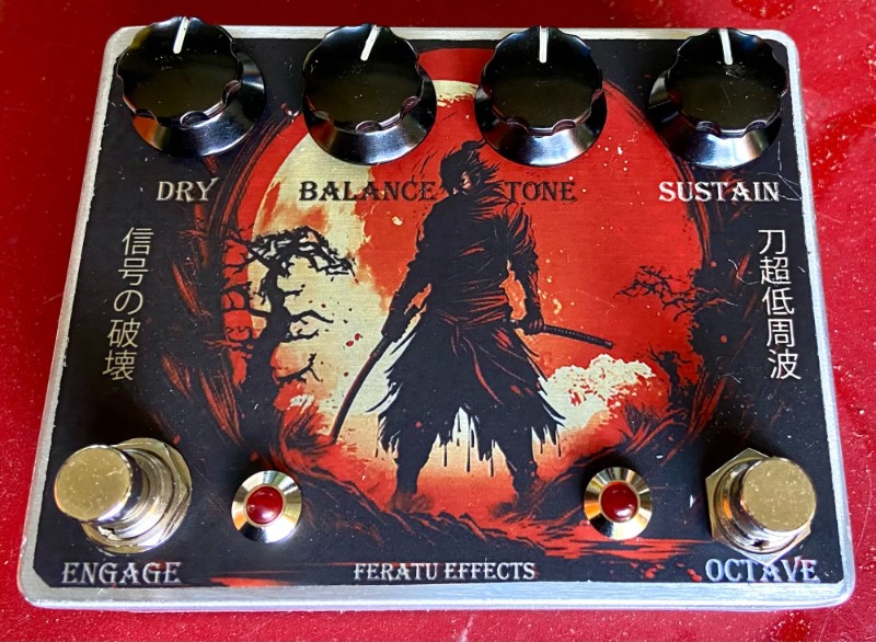

Another Deadend project: LOW BLOW aka Katanasound Super Bass Fuzz.
I matched diodes (D4/D5) and transistors (Q4/Q5) and the octave on the foot switch is very strong.
As for transistors, I have 2x 2SK30A and 5x 2N2222A in there. GE diodes are D9E (D4/5) and D311 (D6/7).
And some "japan/sword" themed graphics, because Katana.

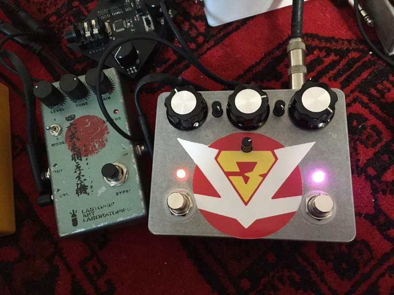

Here my original LAL 046 Superfuzz and its clone built with Deadend FX Shillelagh pcb. As usual amzing pcbs and projects.
Soundwise the clone is spot on, the original being sometimes a bit noisier and nastier.

I have a question: does on your clone the pre and post clip knobs work well? On mine the Pre Clip knob does barely nothing (and I double checked all components and soldering joints, and everything is fine). Post Clip acts as it should.
