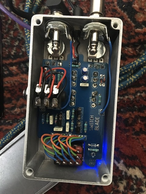

After a long time, it was about time to undust a bit my soldering skills. And here I am with this sweet LAL 88 Oscillo-Fuzz clone!
PCB by Dead End FX, the Switchblade project (big kudos guys!).
I also noticed I have laying around 2 pcbs by Fuzzdog for the Shin-Ei CompanionFuzz and a Univox Square Wave... what will happen if I put these together in the same enclosure in series?!???? :!!!:

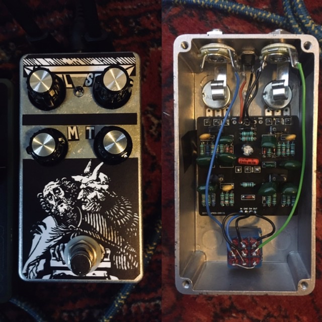

Next: this is a Hizumitas clone!
I built it with the shika fuzz pcb by pedalPCB.
I was very curious about this muff variant, and when I saw the pcb I decided to give it a try.
I installed also a mid knob on the tone section, to have a bit more versatility.
It sounds very cool indeed, it's thick and slugdy as a good muff should be and there's a lot of clarity also with the tone knob fully on the bass side.
I also did an AB comparison with my mighty Earthbound Supercollider and.... the SC can be set to sound like the Hizumitas!
There are some different nuances, but they are so close that I think in a live context you won't notice which is which!
There is only one main thing that's amazing about Hizumitas: it has tooooooons of output volume!!!
Unity is already around 9 o'clock, while on the SC it's around 2 o'clock.

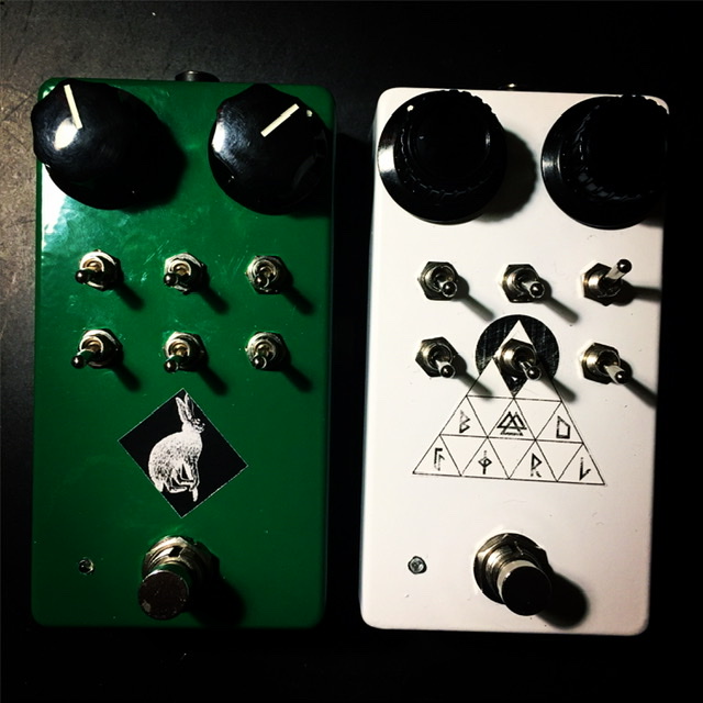

Decided to build another Dumble, so pedal builds have been slim of late. Did manage to get these two built today while I wait for parts for the amp...
Gnawty. Copy of the Big Tone Brewery Royal Beaver. 'Cuz we all know, too much Muff is never enough. This one goes to 11.
Dekadent. Preamp section of the Peavey Decade mini amp. Apparently, it's a "thing" now.

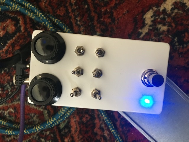

Just boxed up this circuit I've been tinkering with for the past couple of weeks on breadboard. Turned out pretty cool, but have to sort out some switch popping...
A sick ms paint block diagram is worth a thousand words...
Because of all the switches and wiring in and out, I figured it would be easier to break everything down into discrete circuit fragments than to try and do one huge vero layout for the whole thing.
The voice switch selects between 3 different resistors to ground in a big muff tone control which gives 3 pretty different EQ plots:
