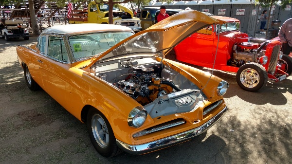

Mopar powered Studebaker:

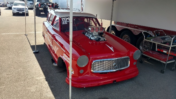

Rambler

Re: The Automotive (& other mechanized vehicles) thread
Posted: Mon Nov 20, 2017 11:48 pm
by crochambeau
Wow. I'd love to see what the gearbox looks like.
