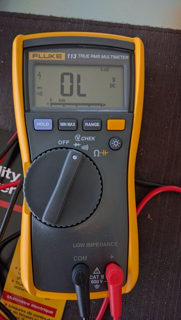

Now...as for the voltage measurements on transistor legs...I had to use both my meters to get readings, and they weren't consistent, so I don't know what to do or what I'm doing wrong. Fluke kept giving me overlimits or just beeping on some legs.
2N3904 from breadboard:
Vici meter - C = 3v, B = 2.182v E = 1.79v
Fluke 113 - C = O.L. B = 1.42v E = .83v

So I set up the board on a totally isolated breadboard with power and input/output, and the volume and gain problem persists.
Have no idea if the problem is a fried transistor or what because I can't seem to reliably get the meters to read out, or have consistent unit of measure. Not sure why that one leg would only read in mV. But the problem is clearly persistent, and other than taking out the one 12K resistor, the only idea I have from here is pull the transistors off the breadboard and use them in the vero board. *shrug*
The volume difference between the two is HUGE. When I set the volume on the amp so that the vero board is still too quiet but loud enough to at least hear details...when I switch to the breadboard it is LOUD. I would guesstimate twice the volume between the two, and the veroboard version has no in-betweens...it goes from no sound (40% of the knob), to clean (50% of the knob) to full distortion/saturation/compression (final 10%).
The breadboard version is nice smooth transitions in gain, from reasonable volume up to VERY loud, and all levels of distortion/break-up/etc.
I feel like some part is faulty...but how do I find the broken thing out of all of it? And why are my meters reading completely different on voltage?

bro your fluke is set to resistance. OL is open load. the resistance is too big to measure so it assumes wire disconnected, open circuit. the beep is a continuity tester that happens when resistance < 50 Ohms. if it beeps when testing voltages, you have the meter wrong. when you have the meter in resistance, you should always have power disconnected. don't worry though, you got good measurements on the other meter.
I think you have the aggitate pot set differently on one of them. also I would suspect that 2M2 with %20 or %10 tolerance can make the difference in gain between two silicon transistors even more noticeable. even R4 and P2 are +/- %10. the 2N3904 is about +/-%10 Hfe. set both pots to 0 check voltages. set both pots to 10K check voltages

It has one setting for voltage, continuity, and diodes...and on that setting it starts up with OL on the screen. When I tested those legs...OL stayed on the screen.
But...I've found that when I manually set the range to 0.000 volts...and then test those legs...it stays at 0.000...whereas adjacent legs give me readings of .671 and .781v or similar.
At least the fluke reads 0.000 when I set it that way until I test something...the Vici has numbers just swimming up and down unless the leads touch eachother...then it zeros out and stays put.

we were both wrong. you have it set to diode tester. I just got the manual.
http://media.fluke.com/documents/113_____iseng0200.pdf

Hahaha. How confusing. Cuz there's only one setting for all those things. One spot on the dial, and no yellow options to switch to with the yellow button. It is SUPPOSED to figure out what you're trying to do and read correctly, but clearly it is not doing that.
It touts "check voltage and continuity at the same time". *sigh*
