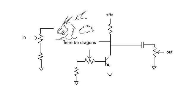

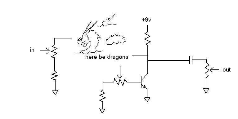

I don't have a schematic. I'm trying to understand it conceptually. This is what I'm trying to work out in my head:
You have a section of a circuit. You want that section of the circuit to interact with the rest of your circuit at an amount relative to the linear path of a potentiometer.
That may still be vague, so I'll see if I can figure out how to draw what I'm picturing and maybe you could tell me if it would work the way I'm thinking.
Ok here's what I'm thinking:
Have to go to a meeting to I didn't finish conceptualizing the circuit. Is that enough to go on?

if there is no circuit then there is no electricity flowing and there is no practical answer to your question. if you want a comprehensive general knowledge of transistors. start by learning what a transistor is made out of and what it does to electrons.
transistor on wikipedia http://en.wikipedia.org/wiki/Transistor
specifically NPN and PNP types (bipolar transistors) http://en.wikipedia.org/wiki/Transistor#Bipolar_junction_transistor
the dedicated bipolar transistor wikipedia http://en.wikipedia.org/wiki/Bipolar_junction_transistor
this book is way easy to understand http://www.amazon.com/Getting-Started-Electronics-Forrest-Mims/dp/0945053282/ref=pd_sim_b_2
this one will not skip over the college level tech talk http://www.amazon.com/Electronics-Self-Teaching-Guide-Teaching-Guides/dp/0470289619/ref=pd_sim_b_2

jfrey wrote:
so can I replace the dragon with a pot? is that what your asking? why not just draw it with a pot? if thats another pedal inside a dragon, it should only have an input and an output. you dont need to draw the top and bottom rails if its not important. cause looking at your dragon i dont know where the signal comes out. so it STILL impossible to answer your question. no matter how many dragons you have.

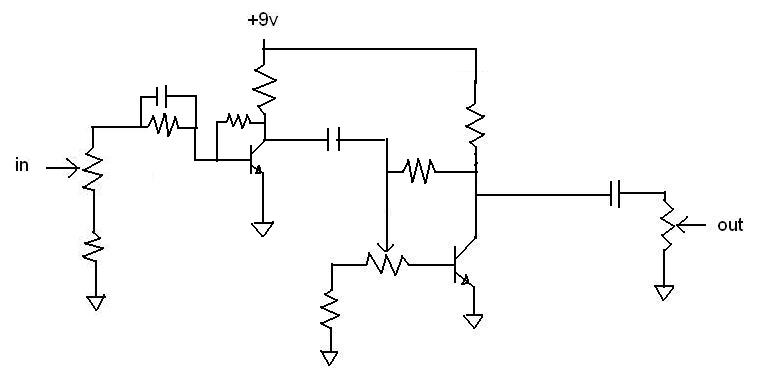

Looks like my meeting is delayed another 20 mins so I'll try drawing out more. (Make that like an hour...)
OK.... Does this make sense?
So there are 3 pots. The idea I'm aiming at is the pot in the middle of the circuit adjusts the base current of the second transistor (which gates the collectors input current yes?) so that the output changes accordingly.
Again... if that is complete rubbish, please forgive my noobness.

well to be honest, my knowledge is limited as well. I get by on knowing
input/output caps
shunts
passive volume pot
basic high/low pass filters
dc coupling caps
feedback resistor
op amps
voltage dividers
input/output impedance
ohms law
I never really took the time to learn transistors. but I do know how to bias them and test them for gain. thats all that matters when building. designing is another thing.
