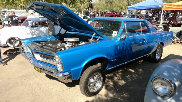

Went to the drags at Famoso too.

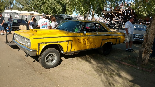

This one is for Changeez: old style dodge funny car (body moved back)

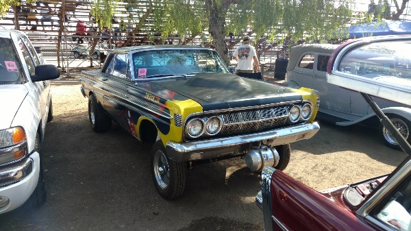

GTO Gasser
Re: The Automotive (& other mechanized vehicles) thread
Posted: Wed Oct 25, 2017 2:29 pm
by Chankgeez
lordgalvar wrote:Went to the drags at Famoso too.
:love: Perfect except for the color. Anything but yellow. :D
Posted: Wed Oct 25, 2017 2:39 pm
by lordgalvar
Yea, didn't care for that yellow or sharpie detail...the fender welds looked a little "for show" too, but it was cool to see something like that. Most of the neat mopars were in the normal dude pit which they hid way far away behind the swap meet...didn't get to over there.

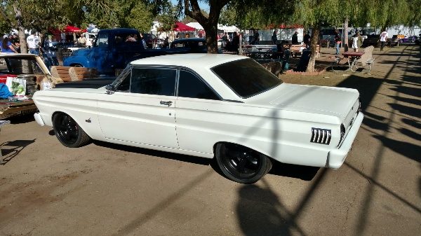

Here are some 60s Ford/merc falcon unibodies:
