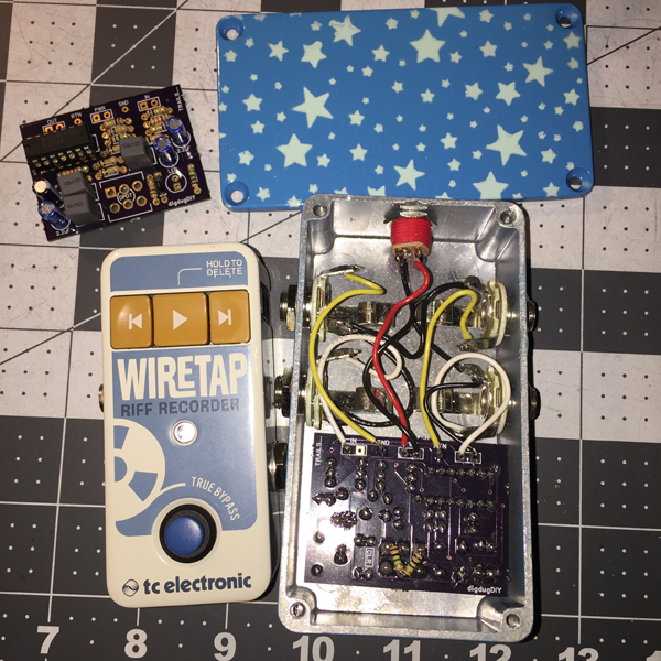

couple things recently
1a. swapped the "stomp" switch on this TC wire tap i just got. i had heard about the crummy switches TC uses
but i could still not believe that they think what they have is good enough to stomp on repeatedly.
its not even a stomp. its a tact switch...wtf!? its laughable. i honestly LOL'ed
1b. an active add trails to anything fx loop pedal & board i made. prolly not the most efficient way to do it but it does it!
was inspired by a thread on here a couple months(?) back where someone used like a boss pedal and a y cable.

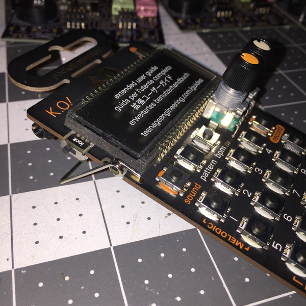

2. i've done a couple of these already but did another one. PO33 KO! modded with better (not jumpy!) pots and a lock switch on the side
mini knobs are for a roland boutique tr08 (i purchased extra knobs from roland's parts department awhile back)

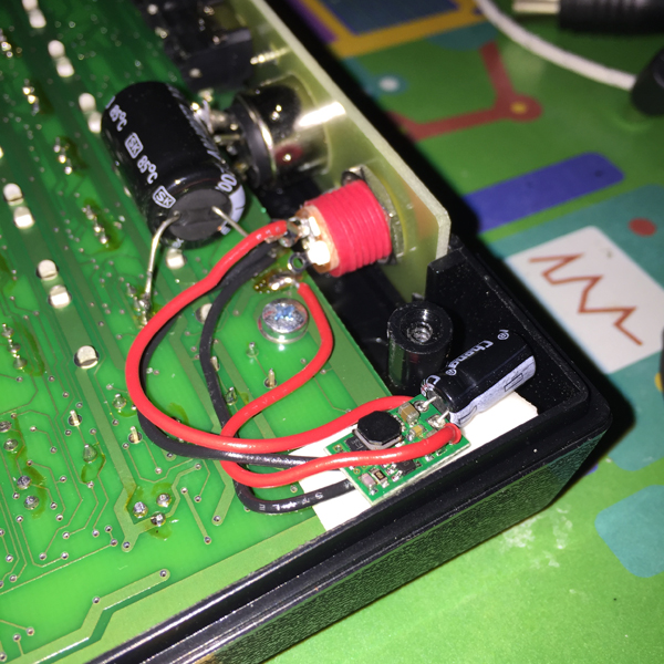

3. modded my MFB 522 which is like an analog mini 808ish clone.
changed the power jack, flipped the polarity to center negative and added a step up voltage regulator so it can be powered from anything below 12V.
USB battery! or just a onespot or something. might try to put a LIPO battery in it for fun but i didn't have the battery charger board at the time.

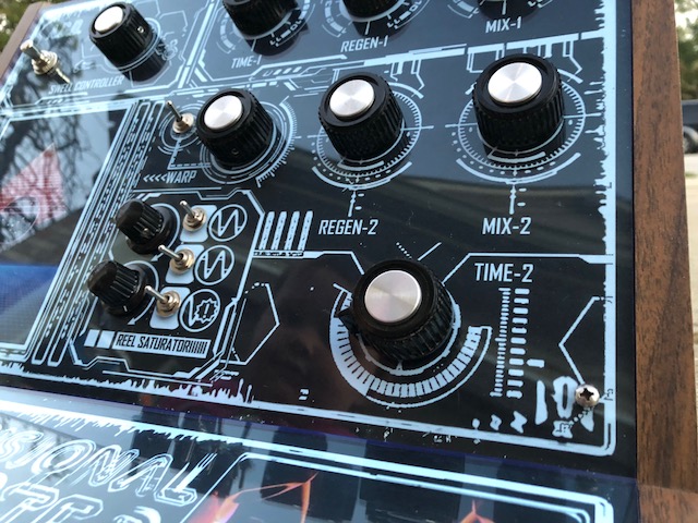

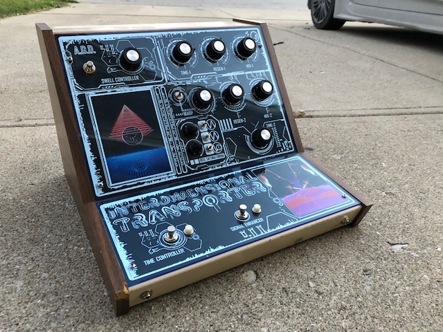

MechaGodzilla
Posts: 2450
Post by MechaGodzilla »
that is a wonderful, holy item.
repoman
Posts: 2291
Location: Edge City
Post by repoman »
That is awesome. Whats it do? Is that a JPTRFX reel saturation in the one part?
F U T U R E G A M E R
dminner
Posts: 1102
Post by dminner »
repoman wrote:That is awesome. Whats it do? Is that a JPTRFX reel saturation in the one part?
Yeah I did some pedal graphic design work for him and he sent me some boards in return. It is a jive into a modified fernweh
