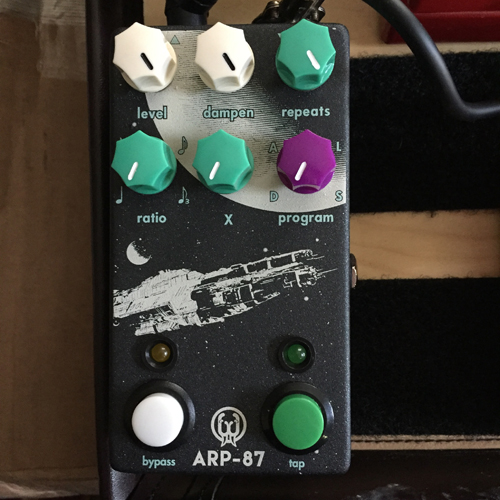

just a mod but got a new (smaller) delay for my live setup...
swapped the footswitches for some nice push buttons
and changed out the ultra painfully bright white leds (why do ppl make them so bright? they hurt my brain)
for some mellower diffused colors.
2017-09-01 15.31.56.jpg (198.79 KiB) Viewed 5569 times
Looks snazzy :thumb:

I've gotten in the habit of using 4.7k current limiting resistors on all my water clear LED's, because yeah, they melt face. I got some 10mm UV LED's which I love, but I think I was going 5.6k on them even.
I just prefer water clear colored LED's to diffused. Diffused LED's look cheap IMO. Try adding a 1k resistor in series with the factory jobs and see if that dims it to your liking!
:joy:
Edit: I didn't even comment on the push buttons! Nice work!

Man, I use 8-10k with water clear.

I have used a 47K on a fucking bastard ass blue god-awful waterclear fucking LED, just to make it manageable.

I go 10k on clear whites, that seems to be a good brightness fit my eyes
