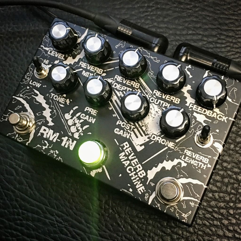

that's incredible..intothegroove wrote:excane wrote:Finally got my RM1N back from jwar. Artwork by yours truly
Not another one like it.
Looks killer buddy! You guys did a great jobCan't wait for the demo! Thanks so much!
