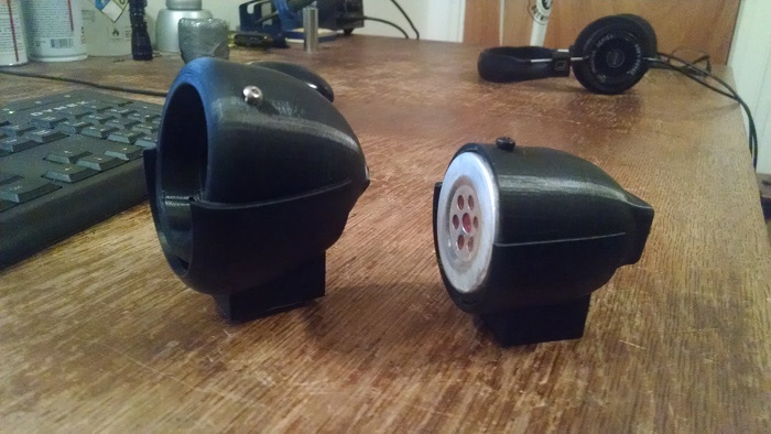

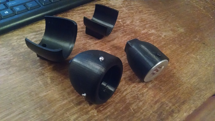

I designed and 3d printed some harmonica mic style shells & mic stand mounts for my telephone mic (I previously had it in a mouthwash cap with duct tape. The bigger one I found the mount itself online already and I made a shell the same size as an actual bullet mic, it's seemed big so I made the smaller one after.

Are you just wiring the 2 terminals on the mic to a jack or TS cord?

yeah just wiring it straight to a 1/4" jack

That's awesome! Cool housings, mang. :thumb:
