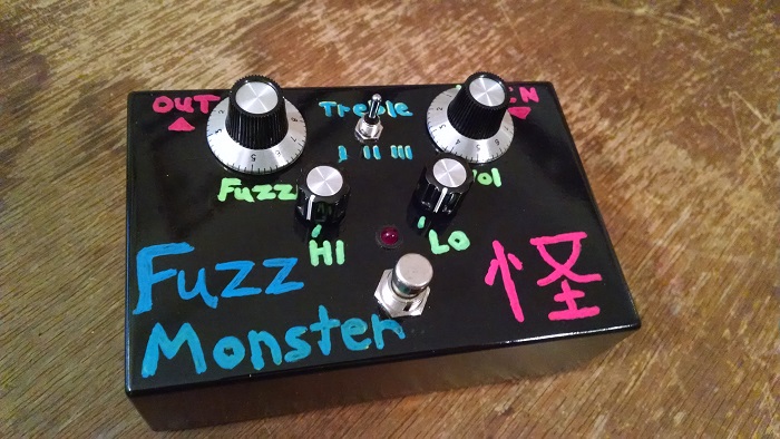

I finally boxed up my Guyatone Fuzz monster clone (digi2t's pcb from awhile back), 2 years later haha. I have zero artist talent and terrible hand writing so paint pens and clear coat it was haha, I like how it came out more or less.

Those are some nice Eighties colors though. :)*
Next time you should send the enclosure to Jen Zink. :snax:

haha yeah my roommate said the same thing, it was part that I wanted similar colors to a real one and mostly it was the only colors in the cheapest multipen pack at michaels.
Haha yeah! does she still live in Minnesota or wherever? I haven't talked to her in years.
