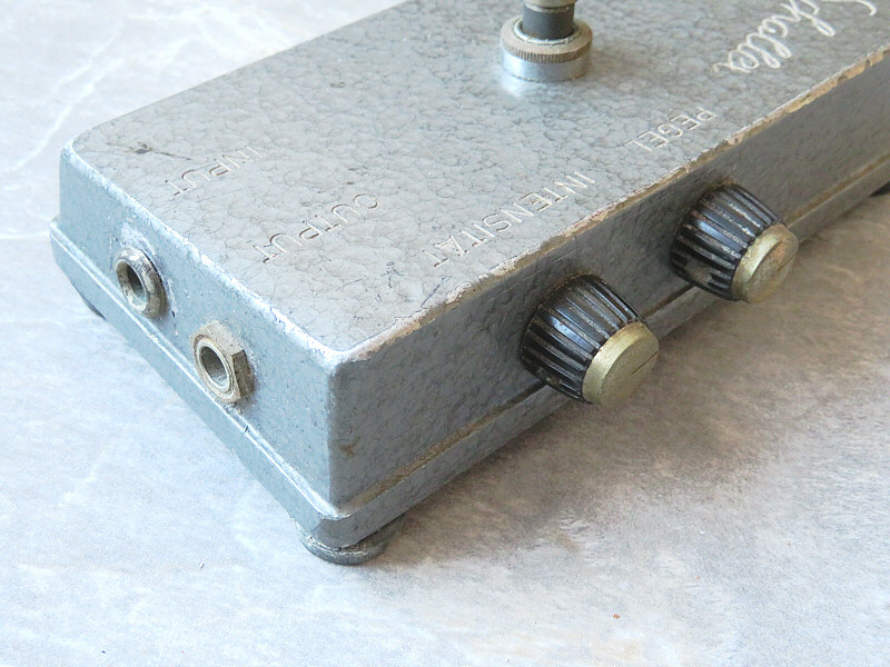

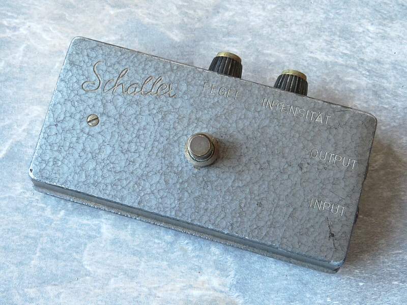

A few years ago a good friend demonstrated me his Schaller Tonverzerrer (engl: tone distorter), a German fuzz pedal that has already been in the Schaller product catalogue in 1969. Ever since then I wanted to have one, too. Last Thursday I immediately bought this beauty when it popped up for sale, listed as defective. Today it was delivered, much to my joy, because due to the sparsely and delayed communication with the seller I had no information that it has been sent off already.
Unlike the two units that my friend has owned, this one does not have a mere plastic chassis sprayed with hammer finish paint. It has a solid metal housing.

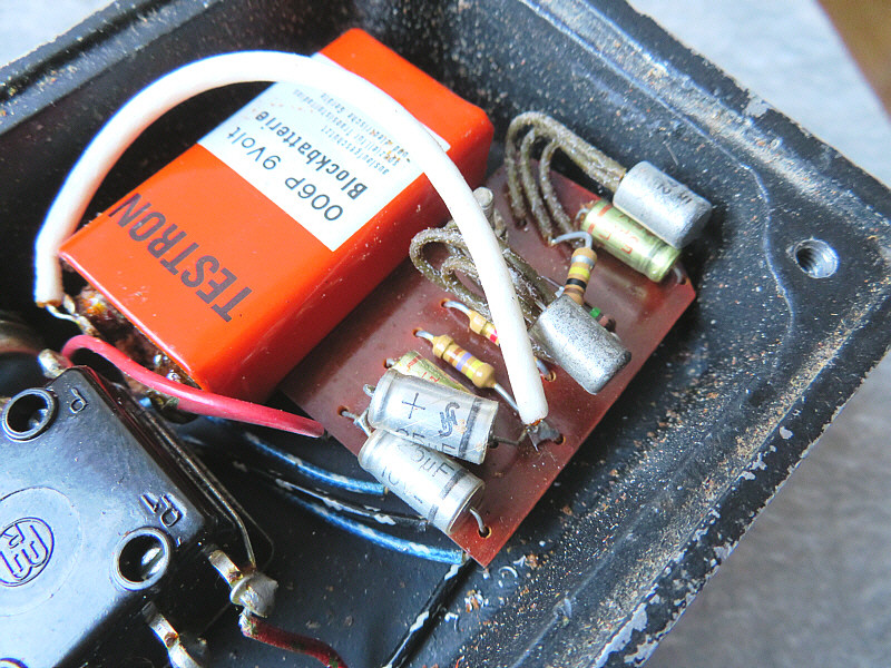

Everything seems to be absolutely original. The electrolytic capacitors are from the big German corporation Siemens. The input jack has the nut on the inside, the output jack on the outside. That looked strange at first, but after seeing a Höfner branded unit with the same jacks I was certain that this is normal in the early units.
Even the battery (with the date "72" on it) has oviously never been changed. Thanks God, it is a non-leaking 9V battery. But: there is no battery snap! The battery poles are soldered to the circuit! Has someone ever seen something like this? So crazy! It really seems to be stock this way.
So far I only heard some crackling bypass sound. The battery has no power anymore. I have to install a clip and overhaul all the connections. I'm sure that it will work perfectly again in a few days.

wow, badass!
soldered battery lugs...something ive never seen before!

I was completely surprised by that view! I wonder if "72" was the production date or the expiration date. I tend to believe it's the latter, so this might be a very early unit. The circuit and the components are also different in comparison to later units.

Instant success! The Schaller Fuzz is alive again, and it sounds great. I have yet to compare it with other fuzzes in the next days. It sounds quite rough at low Intensität settings with a quickly decaying distortion sound, but fully cranked it really sings with lots of sustain and a light octave-up fuzz. It has a lot of headroom, apparently because of the pickups with low volume back then. Power chords result in very hard and thick distortion, suitable for heavy rock. The Schaller Tonverzerrer is definitely a keeper!
I hope that I can shoot a few good pictures of it tomorrow. It has cleaned up nicely. I managed to get the engraved text a bit brighter again with the help of a fine screwdriver and a dirt eraser. And all the bare metal parts are looking a bit more shiny again thanks to fine steel wool. It's not perfect, but for an at least 55 year-old pedal the result is really cool.
Yesterday night a read a bit more about the pedal. In the instruction manual it is called "Tonverzerrer TV 1966/67" and "TV 66/67". So apparently the fuzz pedal was introduced in 1966/67 and therefore the tremolo model "Tr 68" in 1968.
My model seems to be a very, very early unit. I really doubt that the people at Schaller used the user-unfriendly 9V battery with soldered lugs for a long time. Every other old unit that I spotted has a vintage looking battery clip. Someone claims to have a genuine Schaller fuzz from 1967 in this shootout video with a clone that he made. It looks exactly like my model, with the PEGEL (Level) knob right in the middle, aligned with the bypass switch. All the other units have the two knobs more on the right, even in the instruction manual and the old catalogues.
Later models have a different circuit with modern looking transistors (at around 1972), at some point BC237B silicon transistors. This circuit has two Germanium transistors! They are Italian AC192 from TES (Tecnica Elettronica System, still existing today).
