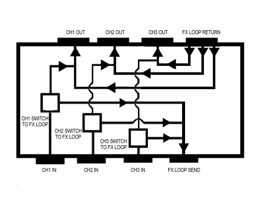

i think i devised a simple solution to enabling manual fadeout of all 3 loopers with a foot pedal. the box would have three isolated parallel channels for each looper's signal with an in/out switch that would assign the individual channels to a effects loop with a mini volume pedal run in it. does this sound plausible?

As long as everything is going into one amp, it’s doable. You’re essentially summing the 3 channels into one, then running the combined signal into an effects loop.dubkitty wrote:i think i devised a simple solution to enabling manual fadeout of all 3 loopers with a foot pedal. the box would have three isolated parallel channels for each looper's signal with an in/out switch that would assign the individual channels to a effects loop with a mini volume pedal run in it. does this sound plausible?
As far as keeping all three channels separate but having one volume control for everything…I’m not sure how you can do that without a triple gang pot controlling volume on 3 parallel loops or clever digital switching. I think the problem is separating the 3 signals back out once they have been combined into the single effects loop- but maybe some of our resident pedal wizards can chime in.

that's not what i intend. i want the three channels to stay separate and discrete while they're in the volume contraption, with each of the three channels individually switchable into/out of an fx loop with the volume pedal in it. the channel would go to the VP and then back to its own original channel, and then out the back as one of three outputs that will then go to my 3-into-1 summing box whence the single output goes to the limiter and then the amp. when no channels are switched into the fx loop it'd just be a powered, isolated 3-channel pass-through box. it seems so simple that it's hard to believe it wouldn't work, and if i didn't hate soldering with the white-hot intensity of a thousand suns i could probably build it myself. hell, i used to work at a semiconductor firm doing product datasheets so if i looked up the symbology i could draw the circuit diagram in about 5 minutes except for electrically isolating the 3 channels and adding the channel switch LEDs. if i wanted to fade a single output i'd just put a vanilla VP between the loop board output and the amp; i need to be able to fade any of the three in/out individually. with the ability to fade one loop's output while bringing in a new loop using the input volume pedals i can effectively crossfade loops like a rave DJ.

i emailed the guy at Saturnworks with a detailed explanation of what i'm looking for and a possible circuit diagram i cobbled together this morning, so soon i'll know if it's a possibility.

This is a fun idea!
Looks like the theory of it works, only thing I wonder about (not being enough of an electronics person to know the answer) is whether it would be difficult to keep the overall volumes the same with all this switching, thinking particularly if everything IS routed through the FX loop, then you have 3x the same output signal then getting summed together in the 3-1 box. Whereas if nothing is, you have 3 separate outputs being summed together in the 3-1 box. Feels like this would make a difference to perceived volume?

the only time more than one looper would be in the FX loop would be if i was ending a segment using multiple loopers simultaneously and wanted everything to fade out at once. i can imagine having everything going at once if i tried to do an "An Index Of Metals" kind of layers-of-serrated-racket thing, but in practice i've never done anything other than fading from one looper to a second looper. even if having all 3 in the fx loop would be a problem the ability to fade one looper without affecting anything else, which is the main point, would be worthwhile. it's a lot easier to work around stopping multiple loops than it is to fade a loop with the looper's level knob.
