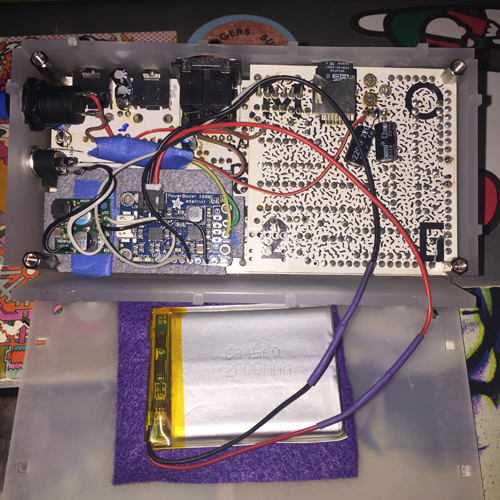

fitted that sweet lipo battery in my MG tonight.
should give me ~15 hours of run, which is a bit more than a standard 9v battery i believe (~8-10 hours?)
either way will be nice not running thru 9v's anymore.
ended up repurposing the existing switch for turning on/off the charger/boost board
by cutting the trace on the switch that usually goes to power
and then just soldering the new power wires in further down the line
so far working good!

Is there any disadvantage to running the MG off a 9v daisy chain?
- Dr. Sherman Sticks M.D.
- Posts: 4049
- Joined: Tue Aug 28, 2007 8:01 pm
- Location: rochester, ny
Re: Taste The Granny: Bastl MicroGranny Thread
it is center positive which is not as friendly for the rest of your daisy chain usually
other than that should be fine. it runs at about 50-60mA
