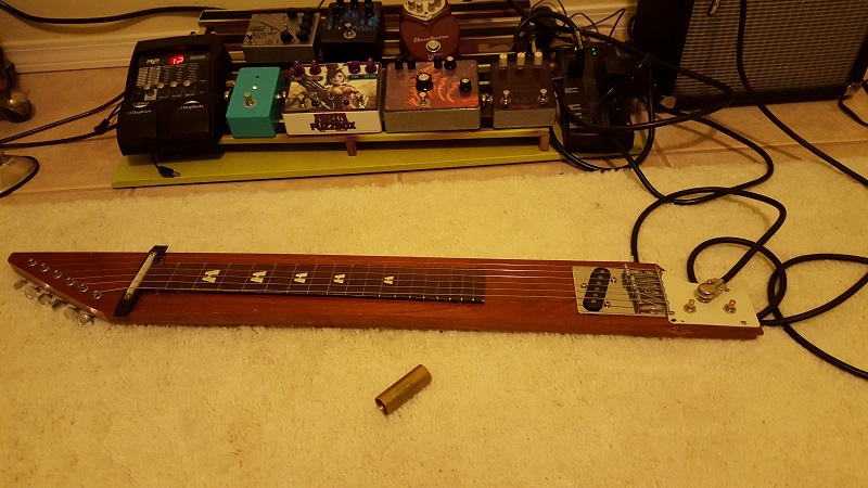

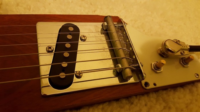

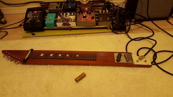

I just finished building a lap steel out of a piece of hardwood flooring and random parts lying around. The "nut" is the bridge from a 3/4 acoustic guitar, from which I also stole the fretboard, the tuners are off a no-name strat copy, and stock mim tele bridge plate and pickup. I made the saddle from a piece of round stock and two screws. It is not pretty, but it works!

Very cool. I'm working on a couple Diddley Bows (one string) that you can play lap or guitar style. One's a resonator. Cool what kind of functional awesome stuff you can make with just a bit of effort!CyaNitrate wrote:Old thread, but is seemed the appropriate place to post.

Nice build, CyaNitrate! Looks fun.

That looks great!

Thanks guys. I came across an old vintage one for $100, but they had no amp to test it (antique shop). I almost pulled the trigger, but figured I could make on for (nearly) free instead. I did have to buy potentiometers. I think my favorite part is the single straight saddle I made. VAST improvement over the 6 individual "Hammer/vintage" saddles that are stock and rattle like no tomorrow.
