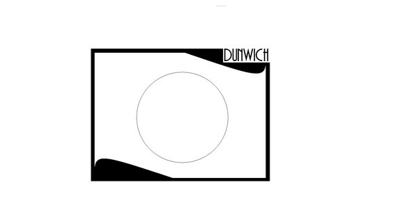

This is the design I came up with. I'll have to see if it's possible. I'm talking with Nick now about it.
I really like this design alot, but the waves curves might be hard to tolex correctly. If you were going stained I would totally so go with this design.
new05002 wrote:Dan is sort of in a catch 22 on this design since he has some conflicting design constraints or ideas. Basically making it small as possible but with enough controls for flexibility leads to the reverse mounted chassis idea. I can do top mounted but I need to expand the size of the chassis and the cabinet to accommodate the mounting which makes everything bigger and some what heavier. It has 7 controls I believe at this moment and for size reduction I even dumped the Standby switch (not needed either way) so that I could squeeze it down in terms of size. There are limitations in terms of how small you can make it with full size PEC pots and a completely turret design.
new05002 wrote:In terms of weight and size it wont be a huge increase going to top mounted approach. It wont be optimally light IMO but it wont be that much heavier.
Since the design above is more rectangular, and using top mount design would make it more rectangular while only marginally adding more weight it seems like this would be the way to go. If you made the cab deeper you might be able to coax some more perceivable low end, but it seems thats not what this amp is being designed for, and I'm not sure it would be worth it as the controls would become harder to access. Which is something to consider since you won't have a footswitch to control the eq on/offs, or will you?

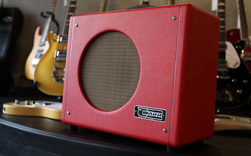

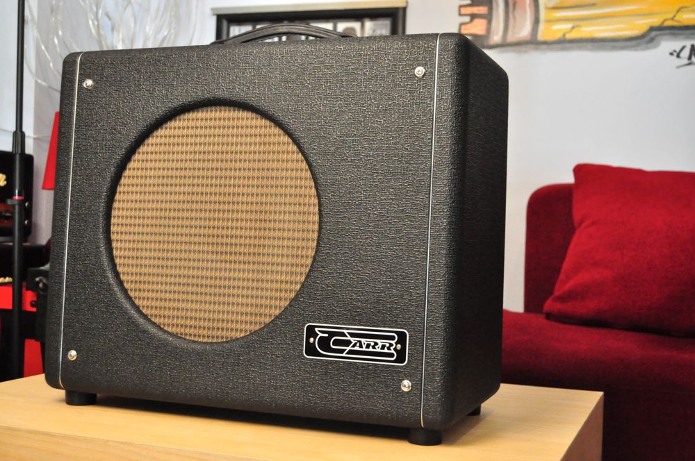

AngryGoldfish wrote:So what's the opinion on red vs black tolex?
Dude that red tolex with black grill is smokin hot. Between the two it would be my clear choice.

I was worried about tolexing those curves. It had occurred to me a few weeks ago that it might not be possible. I'll have to talk with Adam the builder about it. If it's not possible then some redesigning and rethinking might be in order. I could get Tom at HEX to make it and stain it, like you say, or I could have the faceplate on the front facing outwards, just to add some spice to the look, though I'd rather go the stained route.
The actual dimensions will be something like 21"(W) x 17"(H) x 12"(D). It'll be less rectangular than my mock-up. I'm just terrible at art.
That red tolex amp actually has, I believe, the same grill cloth as the other one. It's just the way the light is hitting the amp in the photograph.
