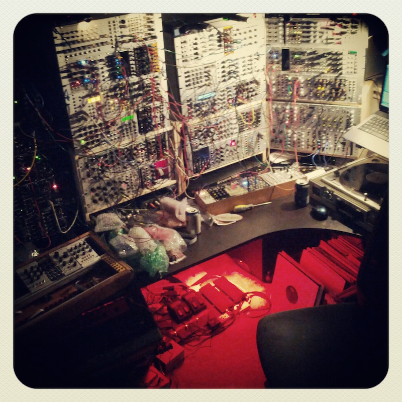

The Pitts mixer used to be not so good. Not sure if they fixed that. Anyway, they don't call it Eurocrack for nothing.
