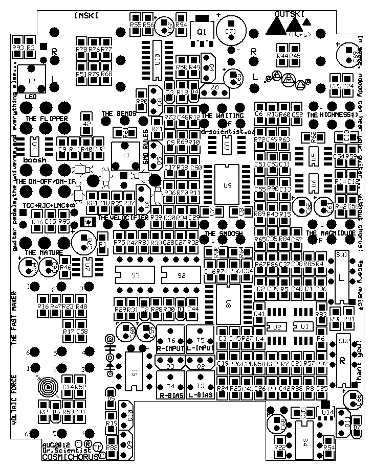

Well, I ordered another proto pcb on Sunday, hopefully will be here for Friday. I did about a dozen tests to the last proto to get the clock noise out of the left signal but I really think it comes down to proximity. The delicate sensitive input pin of the left BBD was about 2mm away from the noisy clock pins...
So this layout has the clock moved away from the BBD chips, adoy, and now I'm super anxious/nervous to find out if it's gonna be quiet or not! If it's quiet, we're golden. Everything else is tweaked and set up and ready except for one further pondering of the box depth... the 1590BB vs the 125BB, same length and width but the 125BB is about a quarter inch taller and would make the build a lot easier except sourcing that size will be awkward since 4Site doesn't make them... so I'm still pondering that a bit...
Hopefully this weekend I'll build the bestest proto yet into a killer box etched by Jwar...
