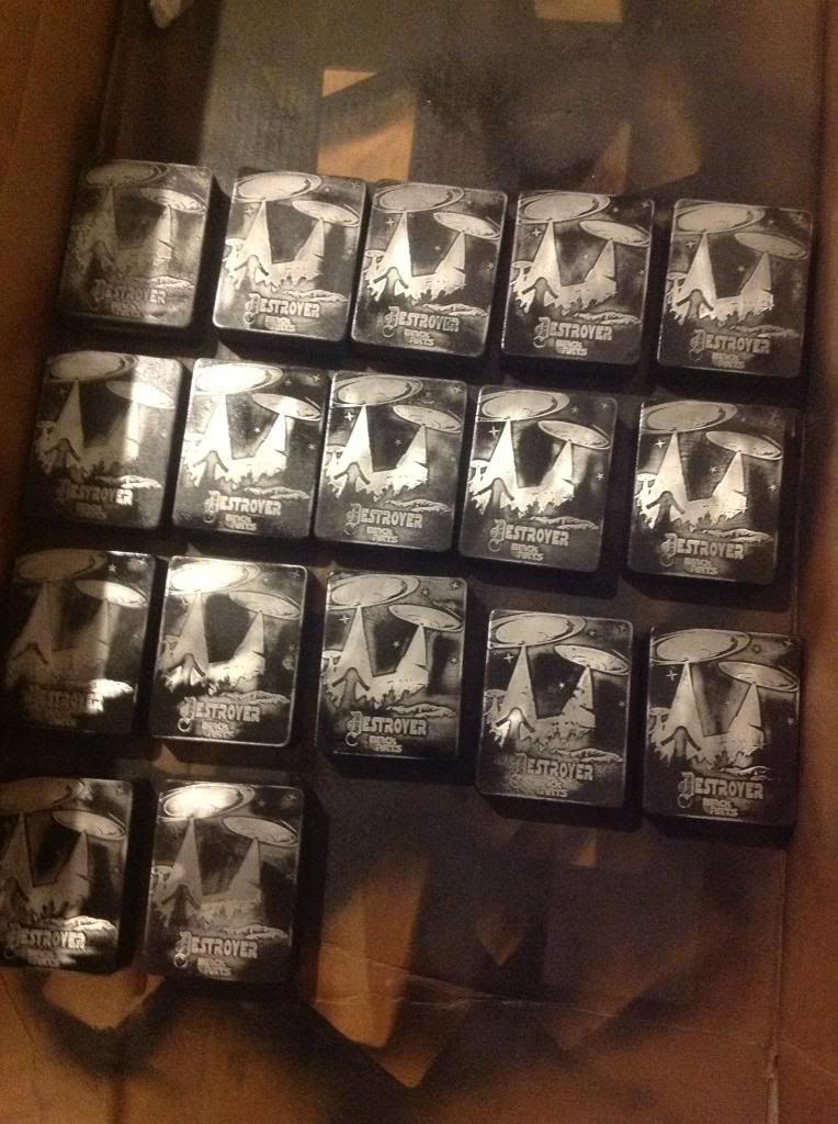

So I found something that works better than Ferric Chloride to etch with. It does not require the perfect temp, it helps, but you can etch in the cold. Plus it way safer than muratic acid. It's called acid magic. The base is actually Hydrochloric acid. Which is cool. It's easier to dispose of and I can use the remaining acid to clean my drive or porch or whatever.
I did 18 enclosures at around 1 min each and almost all of them turned out perfect. I've been experimenting with longer etch times, and they are turning out great! So much more depth and clarity than with Ferric and it's cheaper.
jwar wrote:So I found something that works better than Ferric Chloride to etch with. It does not require the perfect temp, it helps, but you can etch in the cold. Plus it way safer than muratic acid. It's called acid magic. The base is actually Hydrochloric acid. Which is cool. It's easier to dispose of and I can use the remaining acid to clean my drive or porch or whatever.
Anyone else ever use this shit? I did it on a whim.
Did you have to use any sort of oxidizer, or did you just use it straight? How much did one bottle run you? Looks like the same stuff I use, but with some sort of fume suppressant (and maybe oxidizer to allow lower acid concentration).
I would definitely try it if it is safer, although I have had no problems using HCl outdoors in small quantities.
I will note, however, that leaving a small container of it in your shed without properly affixing the lid will result in a boatload of rusted tools, and a may require a door knob replacement.
Hey! I used it straight! Small fumes, but not much. I wear a mask, so it's no biggie. I think it is definitely safer though. The bottle was like 8 bucks at my local hardware store. Not very expensive. I'd give it a shot for sure!
