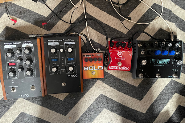

My carrier is semi-broken. The rotary switches were kind of messed up when I got it (and i knew going in I had to fix it).
The LFO seitch was completely frozen but I fixed that by turning it really hard haha; it still feels wonky, but works.
The actual carrier wave one feels normal to turn but it doesn’t change off sine. I have test just about every thing around the switch (It’s what Piotr thinks is wrong too) but the switch is fine. I trace most of it, but I always put it back together and play it. Works great other than different carrier waves.
That’s the reason for the different knobs though: they were busted and I actually used them like that for a long time. But some started to crumble making the switches a pita to turn and all of those knobs were just around the house.
Might record something.
That carrier wave thing is really weird. There just isn’t much going on on that side of the pedal. I’ve gotta start look for bad solder joint on some of the smd whenever I get a magnifier of some kind and more time.

Damn. Did you tried to ask Piotr to send him for repair? Mine arrived with one broken switch (LFO, same), which was replaced by local pedal repair dude with short instructions from Piotr.

Nah, Piotr had the same suspicion as I that it has something to do with the switch (because everything else works). Too much money to send to germany for a switch.
Anyway, kids woke up late today. Forgot we had a microscope for them (Pepe knows what I’m talking about). Poked around for 5 minutes tracing the switch path back to the voltage regulator and the cpu. All looked good except the solder wasn’t great on the smd resistors around the switch. Melted some no clean kester on those but no success. Really looked how the switch was setup and it’s a voltage divider with the resistance to ground being selected by the switch (like if it was a pot with a fixed ohms at the first lug to wiper and variable ohm to wiper from the third lug. Lug 1 and wiper connected at the center pin of the switch).
Microscoped that and it kind of looked like flux residue. Checked ohms but it wasn’t reading what I would expect. Check continuity from top resistor to simulated wiper…nothing. Checked that connection again and the trace was very slightly damaged but covered in flux residue. No clean solder to bridge the pin to resistor. Reflowed all the over smd joints around the switch for good measure. All carriers work! Not bad for sitting down and actually thinking about it for 20 minutes (and working while people sleep) haha.
