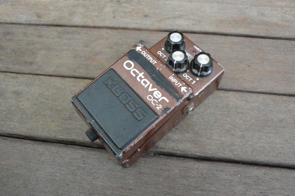

greeny23
Posts: 612
Location: Sydney, Australia
Post by greeny23 »
so the OC-2 landed today. hooked it up before a FZ-2 and RV-3 and pretended i was an organ in a thunderstorm for like an hour.
