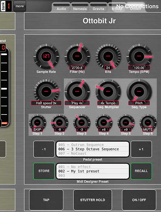

Midi Designer controller taking shape ...

Woah. This is so cool. Too bad it's ios only

FretNoMore wrote:Midi Designer controller taking shape ...
fretnomore - what are you using to interface between iOS device and the Ottobit Jr? Does Midi Designer allow you to store more presets beyond the 16?
FretNoMore
Posts: 84
Joined: Sun Jul 26, 2015 2:19 am
Re: Meris? Blade Runner inspired reverb? & Ottobits too!!!
Post by FretNoMore »
You can use any iOS to MIDI interface, in my case Alesis iODock or Apple's Camera Connection Kit to a Focusrite 18i8.
Midi Designer can store many more presets (don't know what the limit is). What I do is set the list of presets to be a "supercontrol" for all knobs and buttons on the page, and when you recall the preset all knobs/buttons send their value to the pedal.
