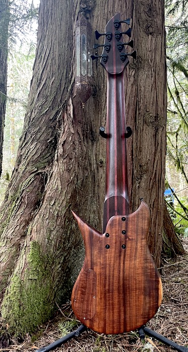

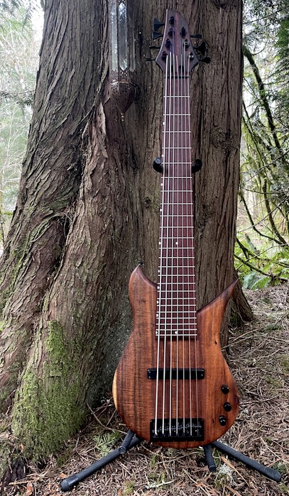

The wood is koa
People do do built up finishes with tung oil but I would not recommend it, you drying times are going to be lonnnnggg. You really want additives like a teak oil (deep rabbit hole) or true oil. Also you might want to use thinners..
I did not thin, I’m just doing 3 coats where you really rub it in to the wood and wipe off all the excess, then I’ll do a coat of wax. Right now it’s going to sit and cure for a week of so

Bass is done!!!
Sounds... huge!, plays fast, weight about the same as a jazz bass :thumb:

:love: That thing is a beast! The neck is super cool. Great job!
