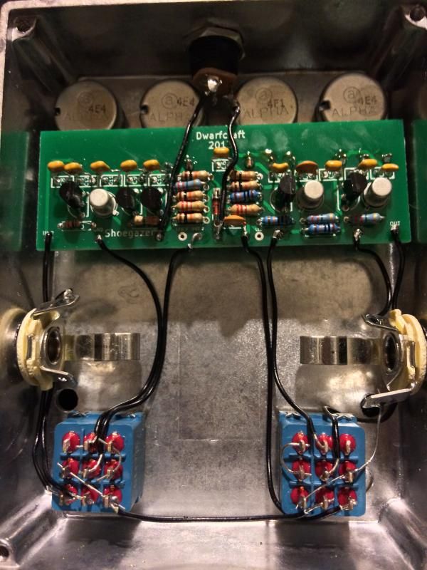

The Shoegazer kit build was a success! :!!!:
It didn't initially work, but then I realized the DC jack wasn't wired correctly. :facepalm:

Post by psparrow »
I had the exact same problem with the DC jack, otherwise everything seems to be working fine with my build. I wanted to make sure though is radio station bleed in normal? This isn't really an issue for me, but I wanted to make sure that this isn't something to troubleshoot later on.
