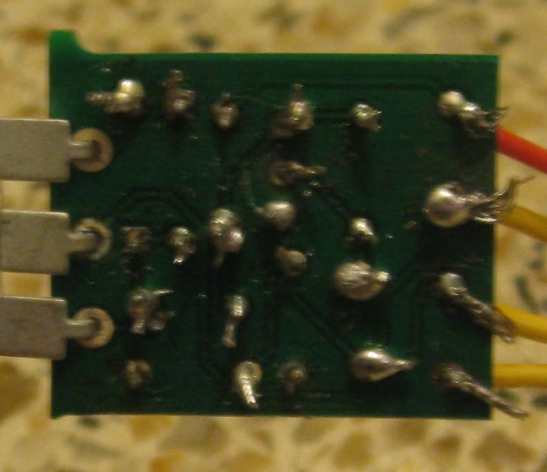

OK I have a couple of pics, one with flash one without, they might not be much use in which case I'll wait til it gets brighter and take more but I thought I'd throw these out ande see if you get anything from them, prepare yourself, it isn't pretty :sick:

the top pic is pretty clear.
i think your big issue is going to be getting a solderin iron with a nice fine tip. youve got some big old blobs and hten some joints with little to no solder. lots of cold joints. what i would do, is get the new iron, and touch it to all the joints so the solder reheats and melts and sucks up into the joint. then the handful of joints that have little solder will probabbly need some more. there is one in the toppish middle that looks like it has hardly any, as well as one right by the pots legs.
so with a new clean iron try reflowing all the soldered joints and see what happens. also double check your wiring to the jacks and stuff, maybe a picture to verify that as well will be good.
also make sure yur transistor is oriented correctly.

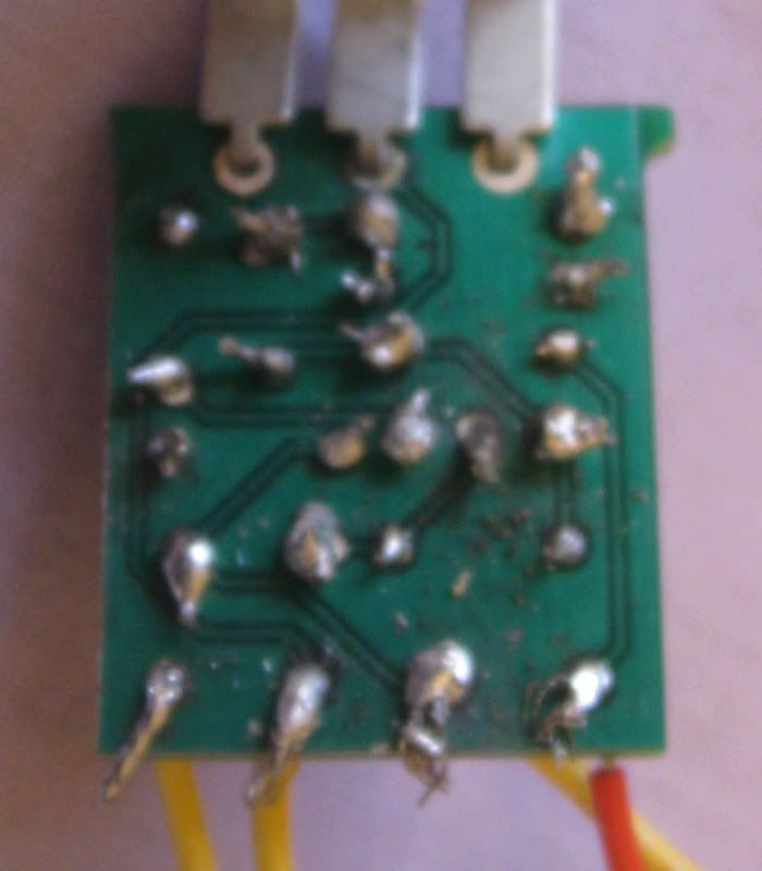

OK, I just had a go at fixing up some of those joints with the iron I already have, didn't fix the problem so a new iron it will be it seems. I hvae taken a few more pics though, firstly of the back of the board now...

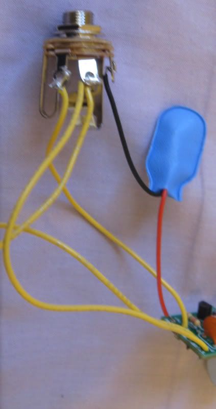

Input jack...
The wire furthest LEFT goes to 'In' on the board, the MIDDLE wire goes to ground on the board and the output jack, the wire furthest RIGHT goes to the battery clip (have I got this right?)

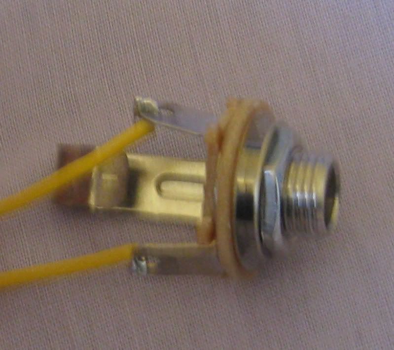

Output jack...
The TOP wire goes to the Input jack and the BOTTOM wire goes to 'Out' on the board (any mistakes here?)

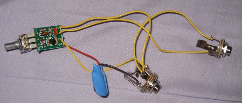

The whole thing...
