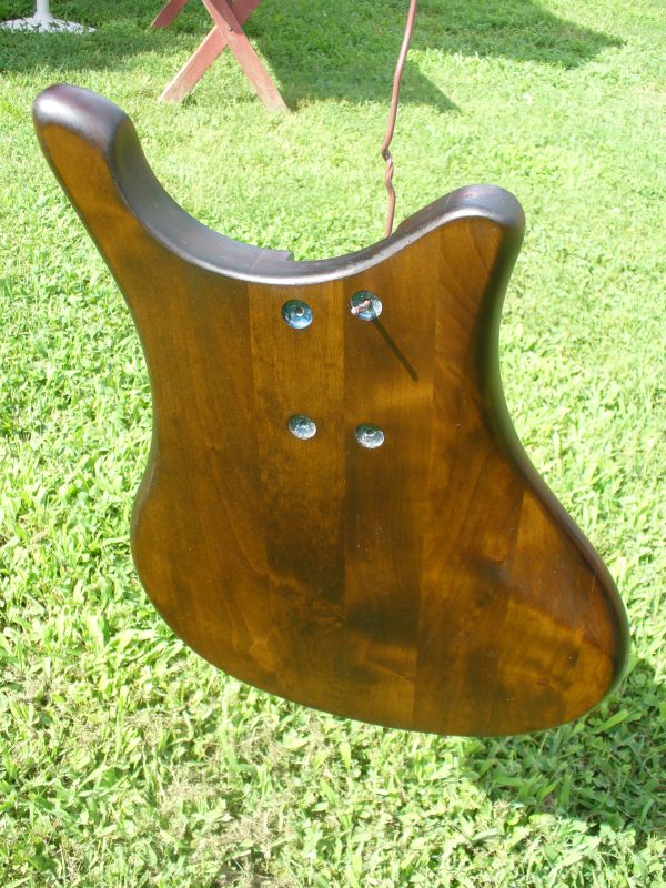

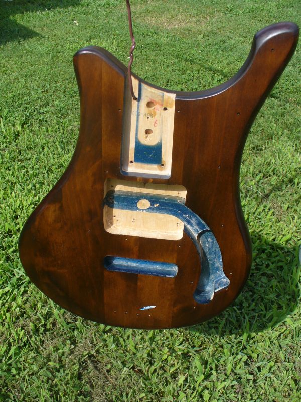

The grass throws the colors off a bit; it's not THAT red/yellowish.
Second coat of oil on.
Maaaan I wish it were a one or two-piece alder body, but I won't be too critical. Anyway, I think it looks pretty durn good for what it is.
I think I'm putting the oil on too thick, but I do like working with it. Apparently my tack cloth didn't remove everything after buffing 'cause I can still see steel wool fibers hanging off and it's driving me nuts. I'll buff it again, hopefully knocking out the slightly-embedded fibers, and then make super sure that it's wiped clean next time.

This is badass! +1 on the mirror guard, too...I was afraid to go elwood-style on this one, although I was considering lightly going over it with a torch :lol:

I think I put the oil on too thin when I put it on the Telemaster looking back at it haha :lol: Looks excellent with the oil man!

looking real good! the multiple pieces look almost like a neck-through with the finish on. i may have to go with tru-oil for the Musima.

Buffing it a little with the steel wool did get the leftover fibers out, and after wiping it thoroughly there were no more problems. Third coat's done, and I applied it with my (gloved) fingers this time. Seems like the way to go up until the final coat where I'll use a coffee filter or something to even it out. I think I'm going for 7-10 coats.
Dubkitty, you should go for it, man. It's a pleasure to use, especially when compared to temperature/wind/humidity-sensitive shit. The easiest technique so far seems to be dipping a finger into the bottle, wiping a bit of oil on a spot of five inches or so, and just rubbing it into the wood . If you have an iron elbow the oil will eventually warm up and maybe it's a placebo thing but it feels like it's working better that way :idk:
Then just pick a new spot and feather the oil into the previous spot. Looks superfine while it's drying, too.
It dries in the sun in just a couple of hours, but inside takes like five or six.

So, turns out I was putting it on too thick, and all it took is one decision to apply it in the sunlight (so it'd dry faster) for it to turn into a tacky, runny mess that I had to wet-sand back down to layer one. That was dumb. Oh well. Should only be another week or so to finish the body, and I've got plenty of time before it's possible to get the electronics and stuff.
Apply it SUPER thin...and in a million layers...indoors :lol:
