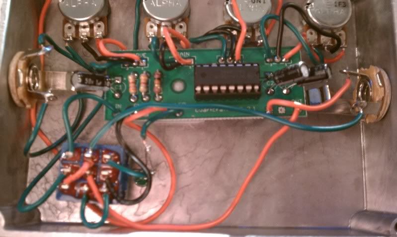

Ok. Can anyone here see what I might have done wrong? I'm getting a bypassed signal fine. The LED works great. When the pedal is engaged, it sounds like static. Not sure what to do. Anything obvious stick out?

Re: TGD Build! Ask yo motherfuckin' questions here!
you wired your switch wrong... or in a way that I am not able to compute at 11:47 pm.

Which part did I wire wrong though? I'm looking at the layout and can't figure it out.
where does your input ground lug go??
