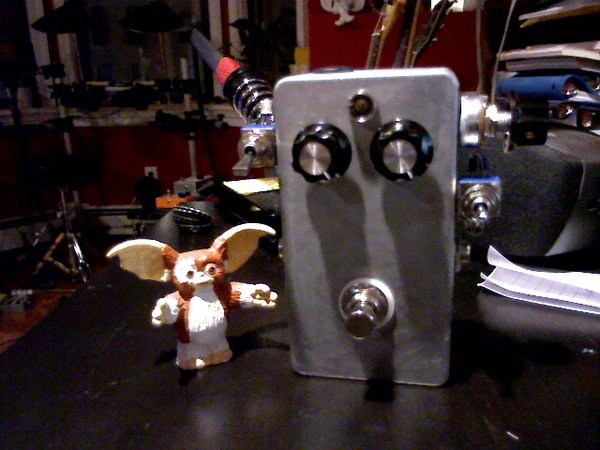

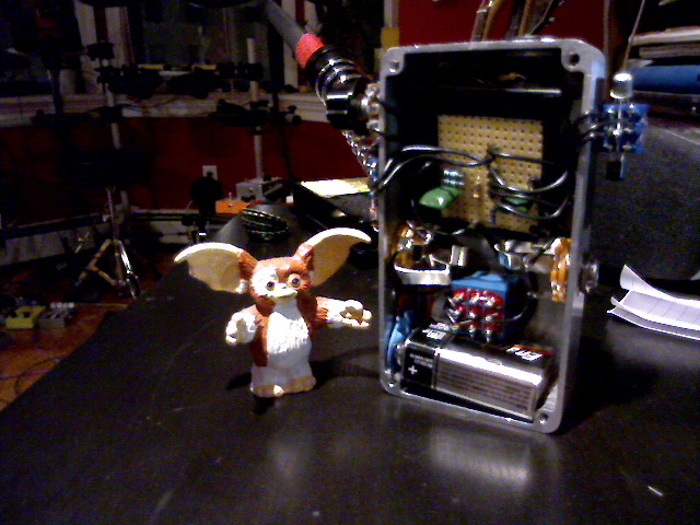

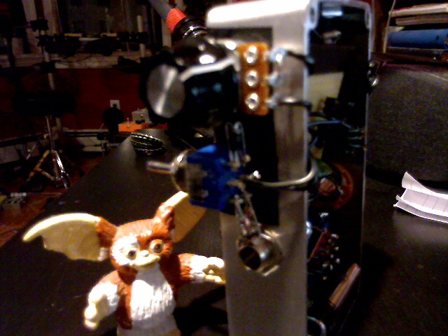

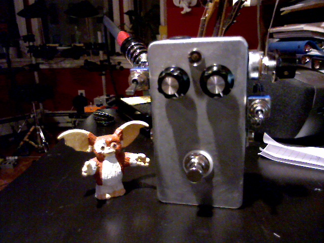

Re: Simulate a dying battery mod
I set up the additional knob and switches on the outside - superglued onto electrical tape. I want to remake this test enclosure in a larger pedal with more options so I didn't want to do any drilling or anything and potentially waste this enclosure.
The current pedal consists of 3 pots, 2 toggles (1 of which is center off), a footswitch, led, 6 resistors, 2 caps, 2 transistors, 4 diodes, jacks, etc. It's my prototype overdrive/fuzz (depending on how you toggle the effect). My first original design.
