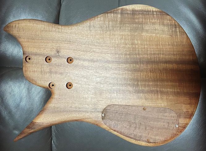

Is Koa heavy?

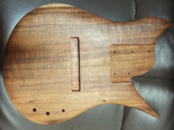

I can relate... I have real hate/love/hate thing with finishing... I think that's why i change finish types every 2 or so projects... This time I'm going with Tried & True polymerized linseed oil & beeswax :idk:
I'd say koa is in the weight ballpark of brazilian mahogany.. Maby a bit lighter but harder or stiffer? I really love the finished product.. This will be the 3rd thing ive done with koa... Hate working it... Stuff tears out if you look at it wrong...

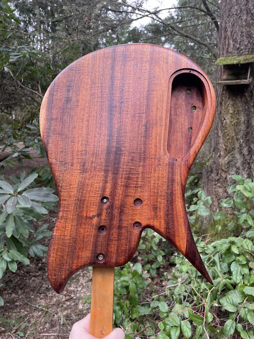

This 7 string project has been the worst for me interns of finding out I just don't have the exact router or drill bit I need :lol: I', stalled yesterday because turns out the 1/2" neck inserts I got actauly measure at 19/32" :|: So I either had to get different inserts or another drill bit.. I ordered the bit.

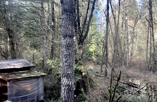

also it started to rain... yeah I know I like in washington.. but it had "stopped raining" for a half hour giving me a window to do a little routing.. [I don't like roughing or sanding inside my little work shed [which atm is halfway suspended over a foot deep pond that happening in my yard during winter...

that is a beautiful piece of wood :love:

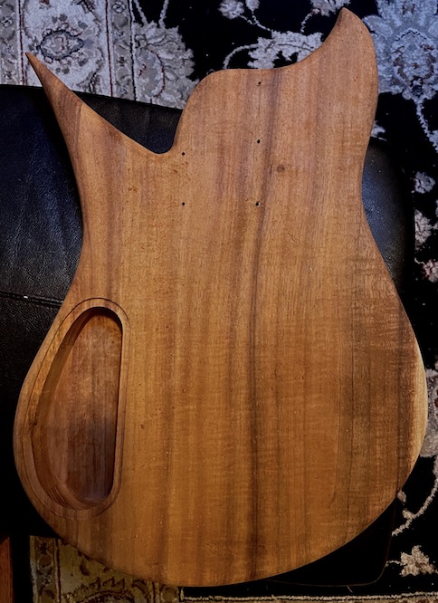

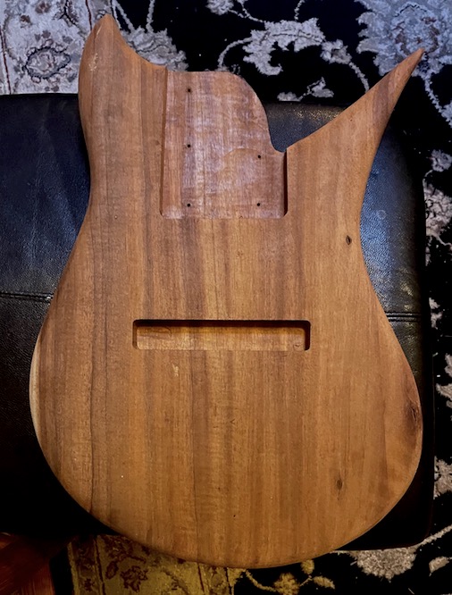

What a difference sanding makes? :lol:
Here is the 7 strang sanded [320 grit] and ready for oil [doing a tung oil finish on this one]

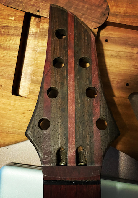

and here is the re-cut headstock

Blackened Soul
Posts: 4783
Re: Frankenstein's Lab! [SHOW YOUR PROJECTS THREAD]
Post by Blackened Soul »
Non the less GREAT WORK!
You do have to be careful though about spacing courses on multi-course instruments. So if you make them closer together at the nut you might want to think about widening the spacing at the bridge to prevent string clanging and buzzing. When I built my 12 string bass last year I had to re-groove the octave string saddles because the factory spacing had them too close together to sound cleanly.

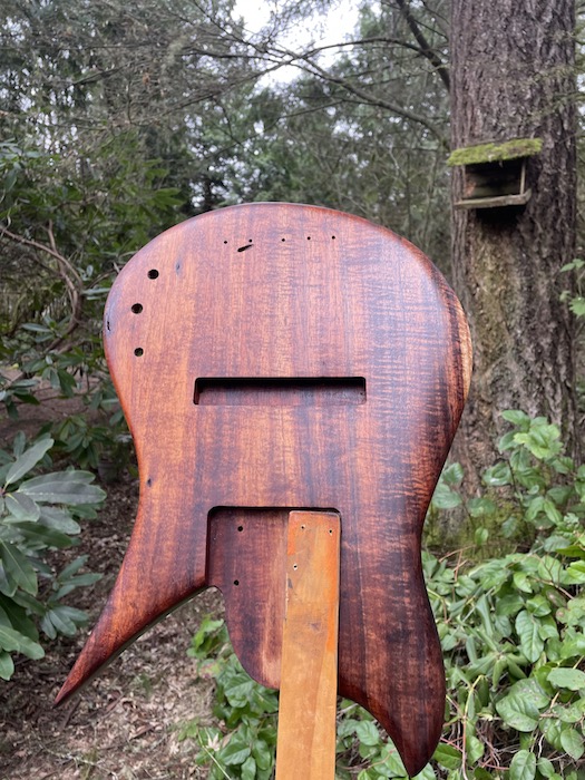

Here is the 7 string bass @ tung oil finish coat #2

Post by repoman »
Awesome, that wood looks really good with the stain/finish on it. What kind of wood is it? Does Tung Oil build up to a finish like lacquer or does it always seep into the wood?
