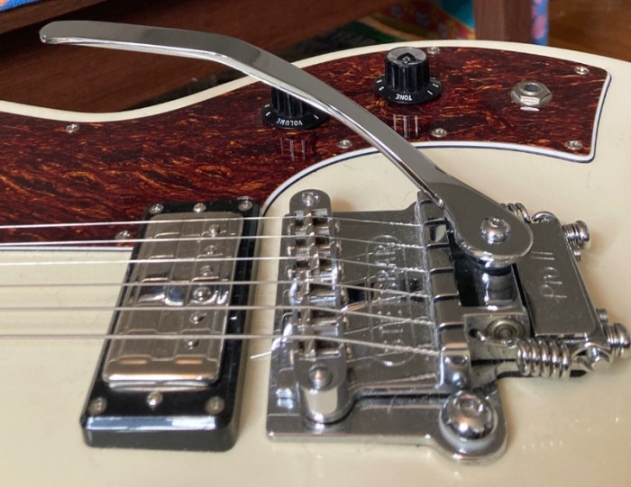

started working on the Jetstar last night. i’m always nervous around power tools, but drilling out the holes for the new anchors went about as well as i could expect. the largest drill bit i own was just the right size to be able to seat the anchors by gently tapping them in with a hammer. i took care when tightening the bolts not to over-tighten them and pull the anchors out. the flat orientation above the body surface is correct; there’s a rubber pad under the bridge plate that keeps it from rattling against the body which dictates the distance.

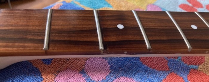

the next thing is the 2d fret. i taped off the area last night before i went to bed, but i’m not feeling precise enough to fuck with it until i have some coffee. you can see that it's uneven and taller than the other frets just by looking.

i finally managed to crank up my courage and do the fret sanding. i think it turned out well—my small ruler as a straightedge says the tops are even across frets 1 to 3—but i don’t want to put the strings back on yet because i have to do the bridge/neck pickup swap which entails pulling them and the pickguard and resoldering the connections. it needs a little more detailing, but i'm not up for that right now. i'll get it before restringing as part of double-checking everything i can think of. it’s funny how i’m having to do everything i always worry about fucking up on this guitar…fret work, rewiring, drilling great big holes, and fussy finishing work. i console myself by looking at the work i’ve done on the other projects and reminding myself that i actually can do this because i’ve done it in the past.

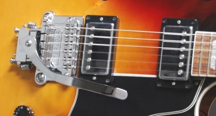

i would have liked things to work in a less Heath Robinson fashion. i don’t love the stacked shims which were the only way to get the strings over the fretboard, but i’ve seen far worse hacks. if the bridge could be adjusted higher i wouldn’t have had to put a bloody platform under the bridge. but when the rubber hits the road it works.

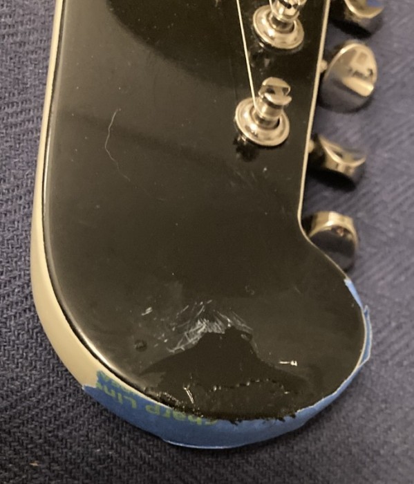

getting started on the body/neck repairs. i decided to do the smallest, least obvious place to start which is the headstock. as previously noted, i think the neck got broken when the guitar fell off a holder high up on a wall. the damage consists of 3 areas: the back of the neck where the break was provisionally repaired, a large ding on the side of the left lower bout, and the headstock. i'll be using tinted medium-consistency cyanoacrylate from StewMac; i aim to fill the black part first, building it up till it's level. after that i'll do the white part.
i taped off the white edge to keep the black glue from getting into it, making it that much harder to cover.
the glue is pretty thick, and seems like it'll fill in space with not too many applications. i'm deliberately making the glue higher than the face of the headstock so i have room to sand and polish.
