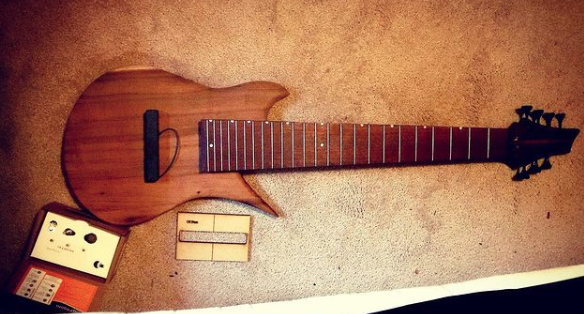

update...
I changed my mind on the 7 string build and while the mockingthunderbird shape is neat, I want to go back to the original koa body [I've actually had this chunk of wood for 20 years, my parents got it for me when they took a vacation to kauai. I think I cut out the shape 12 years ago or something..] I was going to use at the start... So i canceled my brass bridge order for an aluminum one for more body tonez. Also scored a old bartolini 7 string bridge pickup [if you are doing a single pickup bass you ALWAYS want the bridge pickup of the set because it will be louder and bassyier
] from that Dickens guy's sig model, I also got a Bartolini pre
Now I waiting for the bridge before I do a final layout because I want it as close to the end of the body as I can to get the neck as far in as I can get it.
