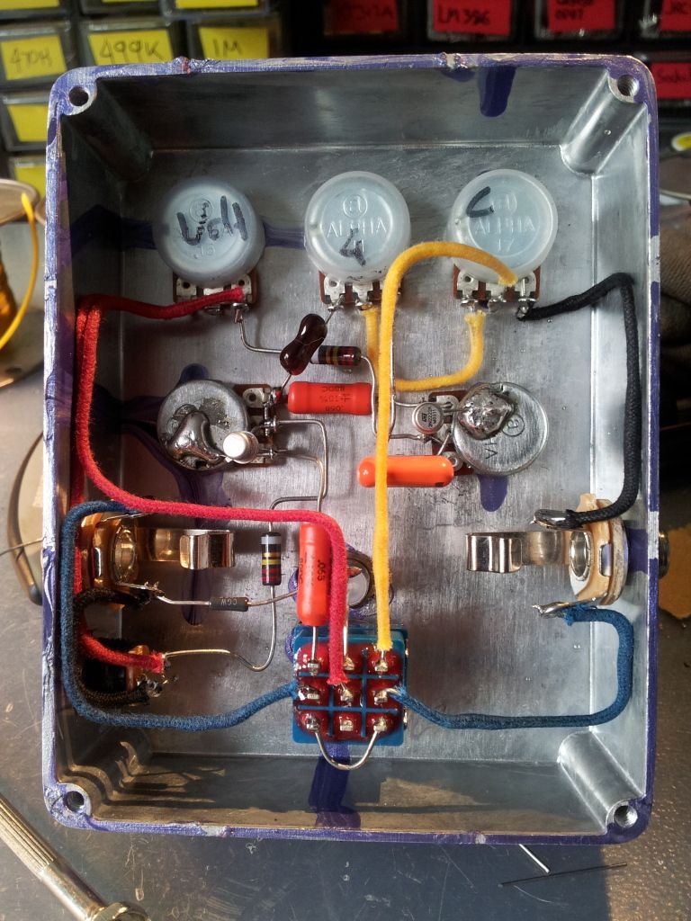

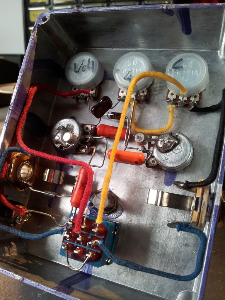

Trim pot is volume, I take it?

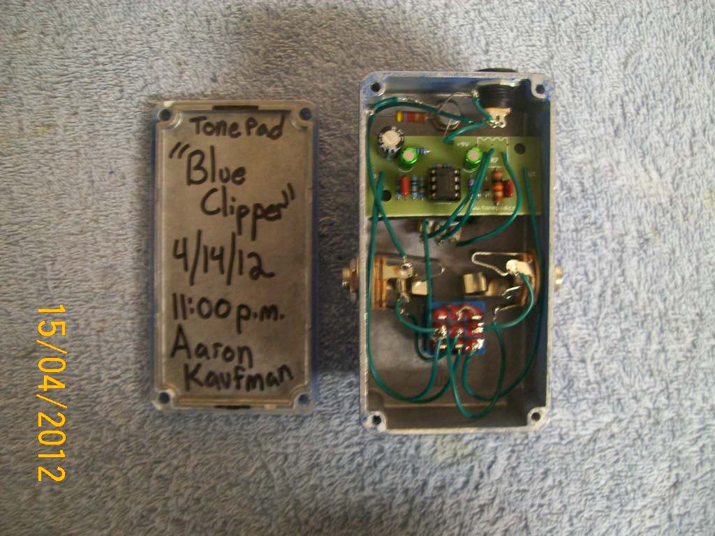

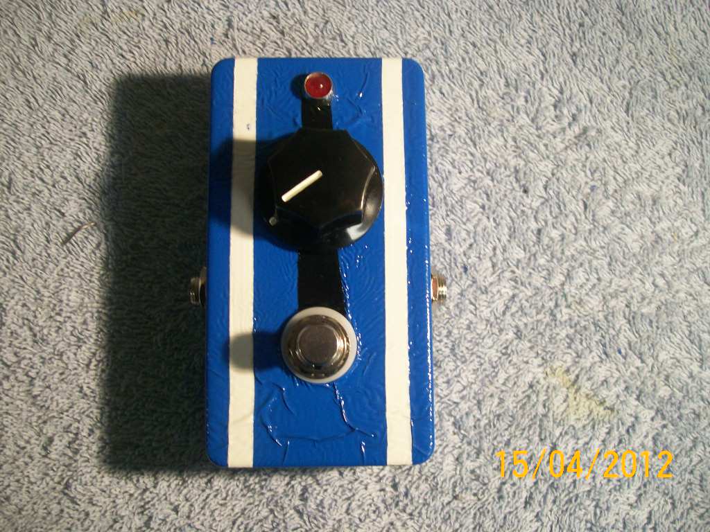

My third build, it's a Tone Pad "Dan Armstrong - Blue Clipper." It sounds like a Marshall set up kinda bass heavy, I love it. The clear coat came out kinda funny, but whatever, I'm still learning.

wsas3 wrote:Trim pot is volume, I take it?
bias.
volume knob is the volume.

The4455 wrote:My third build, it's a Tone Pad "Dan Armstrong - Blue Clipper." It sounds like a Marshall set up kinda bass heavy, I love it. The clear coat came out kinda funny, but whatever, I'm still learning.
Looks pretty sweet. The lines seem pretty crisp this time around too.
I ended up with similar results when i started clear coating, or sometimes even just applying multiple coats of color. I try to wait 48 hours in between painting and clear coating, and then apply the clear in a few fairly conservative coats, maybe 2-3 minutes apart. Not sure if its what is causing your issue but it seemed to solve it for me. even if the paint says its ok to recoat in 1 hour or 1 day etc, i still wait 48 hours.

The4455
Posts: 2441
Location: Chicago, Ill
Post by The4455 »
I think it's because I paint in my basement and it's maybe a bit too cold?

The4455 wrote:
This could be a factor. Could you have sprayed it on too thick? It's better to build up many light layers than a few thicker ones.

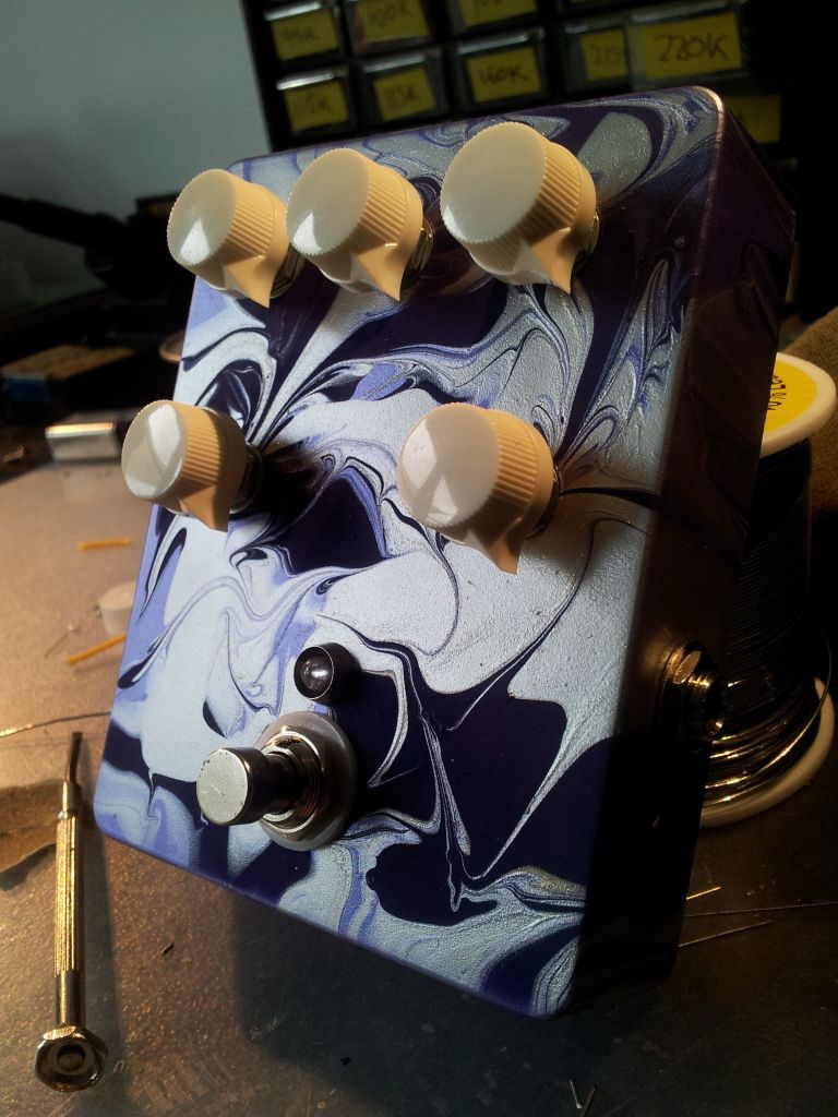

what kind of effect is that,
5pots and 8 composants
