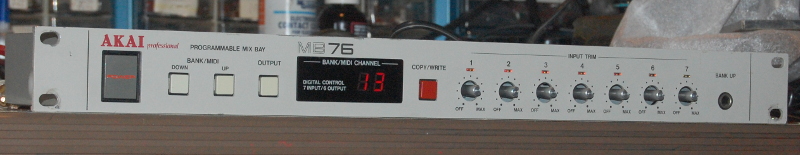

I'm awaiting delivery of a (broken, to be fixed) Akai MB76, which amounts to a seven input, six output rudimentary matrix mixer with 32 MIDI selectable memory slots. 1U rack. Each level control has a very stepped 12 levels, but I expect those levels include FULL and OFF, so I am excited.
I just mention this because the concept seems to fit well with the current arc of conversation.
Edited for pic. Two of the three voltage regulators were suffering from bad solder joints, works a treat now.

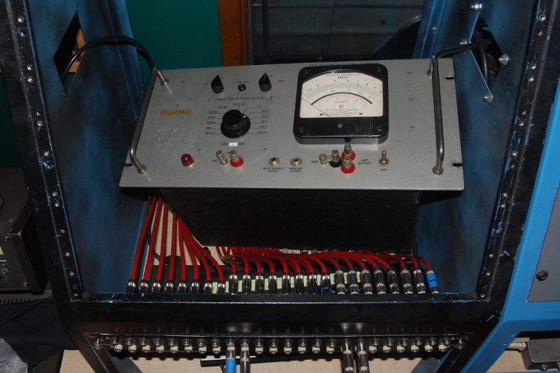

Re: Rackmount Gear Thread
Post by crochambeau »
Shifting some shit around today and instead of growing a third arm to hold this while I removed the last screw I let it fall inside the rack, I blame slots and not my obvious incompetence :lol: .

crochambeau wrote:Shifting some shit around today and instead of growing a third arm to hold this while I removed the last screw I let it fall inside the rack, I blame slots and not my obvious incompetence :lol: .
what is it? an old tube preamp?
good deals/trades/business with: JonnyAngle, rdw102, crochambeau, worra, $harkToootth, Olin, fuzzonaut, friendship, ianmarks, digi2t
crochambeau
Posts: 2215
Location: Cascadia
ibarakishi wrote:what is it? an old tube preamp?
In a sense, yes. It's an old tube voltmeter, which can serve as a pre-amp with coarse 10 dB steps ranging from 80 dB of gain to 40 dB of attenuation. It is a total distortion machine.
