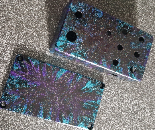

Built a Model-T preamp based off the 1974 schematic. Zack from tagboard did a layout and it's pretty good. I modded it just a bit to get my Jfets to bias up. Used J113's, they sounded meatier than the 201s. I also am messing with the input resistors which are only present to remove RF noise in the amp. I may go with some toroidal chokes I got from China..
Also I always like reverse audio taper for gains so I got 2 C1M pots coming before I finally box it.
The model T has this mystique that surrounds it, but it's not so different from a Bassman with a few values changed and a presence control.. it sounds beefy dimed though.
Anyway heres the box, I have been using "Decoart Craft Twinkles" sparkle/glitter paint for over the top glitter shenanigans and it really sparkles.

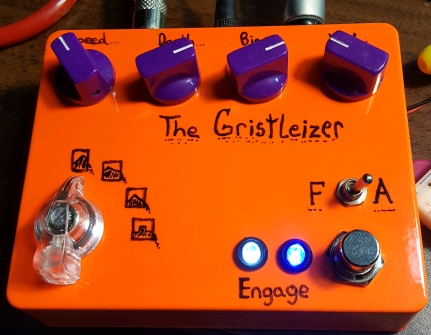

Well I finished some builds. The build that started my whole post here .. the Gristleizer. Finally finished boxing it.. I foolishly decided to cram it in a BB, and everything is off board on the MusicPCB board.. but I got it eventually.

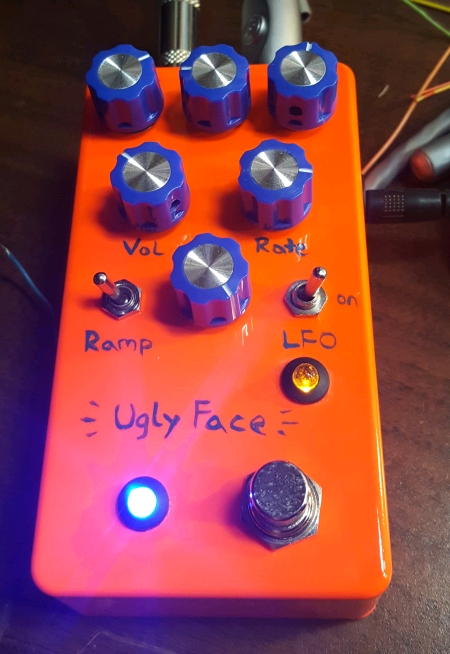

Then the Escobedo (my hero) ugly face with LFO and a couple of mods. Put a blend knob in that mixes straight 386 distortion all the way to the left with full on uglyface bleep bloop on the right. Great mod. The LFO and ramp mod are out There, but not a lot of info on tweaking it. I went with the original sensitivity values .. it can still get down to where It isn't always self oscillating .. lots of fun.
And yes they are the same color. Only two orange boxes I ever bought, 2 years ago.. finished them both in the last week hehe

Sounds like a winning combo of mods and looks spiffy, too.BetterOffShred wrote:Then the Escobedo (my hero) ugly face with LFO and a couple of mods. Put a blend knob in that mixes straight 386 distortion all the way to the left with full on uglyface bleep bloop on the right. Great mod. The LFO and ramp mod are out There, but not a lot of info on tweaking it. I went with the original sensitivity values .. it can still get down to where It isn't always self oscillating .. lots of fun.
- BetterOffShred
- Posts: 3412
Re: B.o.S. builds a .. Rando winter build part 2..
Thanks Chaz.. Yeah it's pretty solid. Love the sounds. It's quite terrible, the LFO part occurs on top of the existing fuzz rather than making it basically a fuzz tremolo.. so setting the speed super slow gives you a surprise every now and then.
