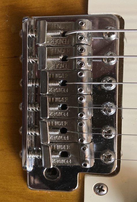

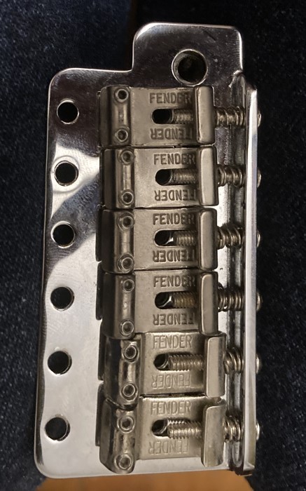

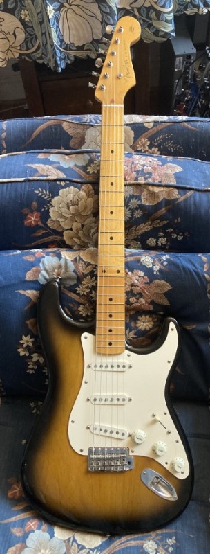

while waiting for the body to be ready i decided to go into my bag of Strat tremolo parts in the parts box and revamp things. the import Fender plate i used is much better-made than the Gotoh plate i was using, better bevels and nicer chrome. happily the Gotoh block fits perfectly.i had some extra saddles as well and changed out the more tired-looking ones as well as swapping out length adjustment screws with chewed-up heads and changing a couple of the height adjustment screws for shorter ones that don't chew up my hand when i strum. the bottom two saddles are visibly different and i notice the new ones are a bit narrower which is good for string spacing over the pickups, so perhaps i should do the others if i have them.
- dubkitty
- Posts: 14822
everything's back together now. i didn't get it exactly right, but it's better than it was and i guess i'll settle for that. it's pushed over a bit to the bass side, which was inadvertent but is good because the high E string is too far from the polepiece on the bridge pickup. taking a break before i do the intonation/string height/pickups.
i'm sure there's old photos showing how much worse it was, but i don't care enough to dig them out. looking forward to having this guitar in good shape again. i'm not as much of a Strat Guy as i used to be, but i still love 'em.

set everything up and it's just lovely. sounds like i remember it sounding 20 years ago. i just love when my projects come out well.

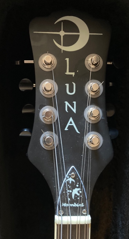

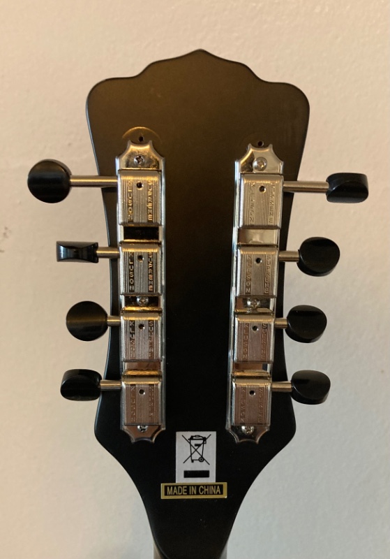

after playing with the electric bouzouki i noticed issues. primarily, the tuners were terrible. using a clip-on claiming .01 cent accuracy, they still were out almost immediately. i’m not sure why they specced the Luna with Gibson F-style mandolin keys, but that narrowed down the options. it is NOT EASY to find high-ratio tuners that don’t cost $250 the set and have black buttons to match the Luna, but i found some. weirdly, they're closed back Klusons on a strip. the new tuners are SO MUCH BETTER. no wobble in them at all. the new knob shafts are a mm or 2 shorter, but my small fingers have no problem with the knob/headstock distance.
unfortunately the old bushings are too narrow to fit the new 1/4” posts. once again i ran afoul of the space between 7/16” and 3/4” drill bits so the larger bit caused chipping around two of the posts. interestingly, this revealed a gloss mahogany finish underneath. i’m not so curious as to start peeling, but i wonder if the original concept was natural before they went with the vaguely goth graphics and flat-black finish. new tuners on left, old tuners on right.
and then to make things even better two of the ferrules for the second strip disappeared. i tore up half the living room so i’m pretty sure they aren't here, thus they either got thrown out with the packing materials or they only sent four. so i found alternate Kluson eyelets on line that’ll fit and have a nicer top profile. i’ll go out today and find the specific bits needed so i don’t damage the treble holes. new bushings should be in next week. i ordered thin washers to go under the new ferrules to hide the chips.
in the meantime, i also have files and a nut blank. when i first got the bouzouki i noticed that the spacing on the third/fourth string course is too tight, which sometimes makes them deaden on each other, particularly on the first few frets. the blank is generic—just try to find a slotted replacement Irish bouzouki nut and let me know how that works out!—and will have to be sawn/sanded/filed for fit. i did a bone nut on the 12-string, so if i’m careful i can do this too. again, it’s not work i love, but it’s work i can do well.

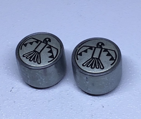

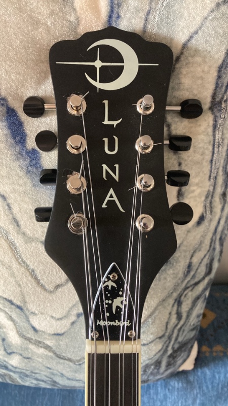

after a fair bit of hassle i finally managed to get the new tuners installed. i really need to get a peghole reamer before i have to redo tuner holes again; neither the drill nor the Dremel with cutting bit worked well at all. happily, standard-issue jack washers cover most of the bits that got chipped. the new tuners are MUCH better…their solidity really helps the tone and sustain which aren’t being dissipated by slop in the mechanism. so i’m classing that as a relative win.
i really don’t want to mess with cutting a new nut for now, but will do when i next have to change strings. i decided i wanted a different vibe from the ancillary bits so i put the black plastic switch knob back on and found some cool knobs by searching “bird knobs” on Reverb and eBay. i quite like them.

Love those bird knobs!
- dubkitty
- Posts: 14822
even my girlfriend, who is not a music person at all and probably couldn’t tell the difference between a Les Paul and a Telecaster without pictures, loves them.
i think i’ve said in this thread before that the reason i spend so much time more or less randomly searching Reverb, eBay, and various shop sites is because sometimes i happen on something brilliant like these knobs.

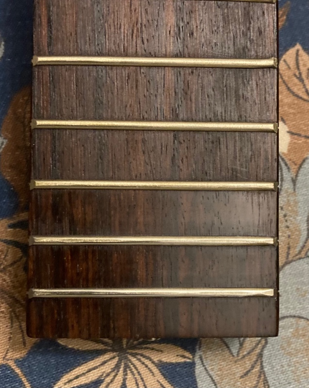

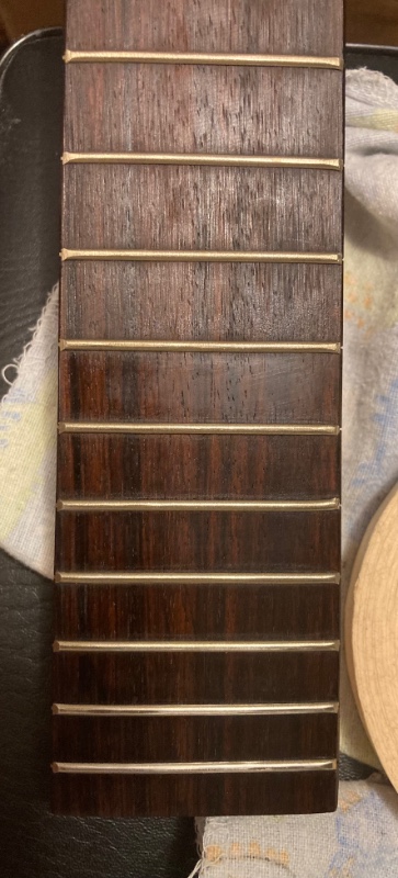

i finally got it up to start working on the Hopf. i thought i might get away with not sanding the fingerboard, but it was just too rough. so i went at it with 800->1200 grit and then polishing with lemon oil. the board is really nice rosewood and feels smooth. i guess i’m never going to get the surfaces just exactly perfect (h/t Bob Weir) but it’s a lot better. the bottom 3 frets took maybe a couple of hours; at this rate i’ll be on to mounting the neck to the body maybe next weekend and then the pickups and pickguard mods which will be the tricky bit. but there’s not all that much to do, so it’ll be ready before spring.

the neck is coming along. i discovered a new way to get the wood flatter and not have a sort of shallow trench because the areas near the frets get sanded down less. i have a titanium camping fun spork i bought for backpacking which has a nice straight narrow handle profile; i wrap sandpaper around the edge of the handle and work down close to the frets before the larger space gets sanded. i’m about a quarter of the way done and am pretty happy with how it’s going. there’s really no point in going finer than 1500 grit because the board’s gonna get scraped a bit every time i bend a note.
